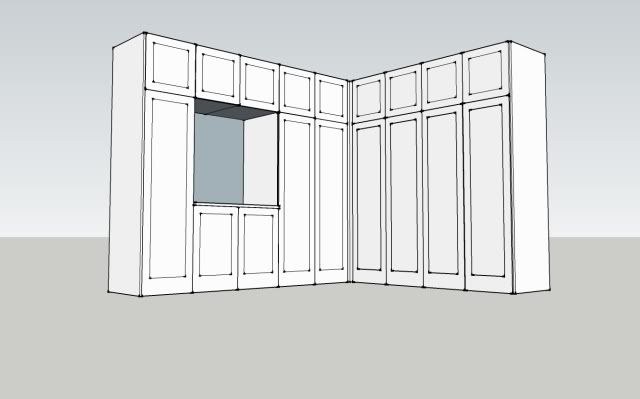

I spent this evening making components for a basic wardrobe . I tripped up on thinking that making them on the red plane would be the same on the green plane so had to make two handed components for each plane . Is that correct or am i doing something wrong ?
Anyway , its very basic but this and variations of it can now be knocked up in no time at all so im happy :D

Looks pretty good for a start.
The blue faces in the opening are reversed and I'd get rid of the endpoints and extensions if I were you.
I'n not quite sure what you mean by making them on the red plane or the green plane. It takes two axes to define a plane. The red/green plane is on the ground plane. Solid blue is up. North, when it matters, is up the solid green axis. The standard front view is looking north so if you want the standard front view to mean anything in your drawing, the front of your project would be parallel to the red axis. You're model doesn't really have just one front. I'd be inclined to put the right side of it parallel to the red axis and the left side parallel to the green.

Maybe i got my wording wrong . If i make a unit 500x600 on the red line and save as a component when i go to use the unit on the green line it is 600x500 . The same as if i make a door for the red line , if i try to use it on the green line it isnt flat to the units . I cant seem to spin components around .
Re: SketchUp , where to start ?
Post by nickw » Mon Mar 18, 2013 8:11 am
Take a look at the rotate tool.
Post by jrm » Mon Mar 18, 2013 8:26 am
Jason, if you have dragged a door into the drawing as a component, you have a 'move' tool active. If you hover this over one of the planes (in this case the top of the door), you will find some red + symbols. Click on one and it becomes a rotate tool and you just drag it round to 90 degrees in whichever direction. As Nick says, you can do this at any stage with the rotate tool while a component is highlighted.

Both ways work and you should get familiar with both tools. You'll need them, a lot.
I was going to add what John did but I made a little short video to show it before I go off to my day job. It picks up after inserting the component.

Post by jfc » Mon Mar 18, 2013 8:40 pm
hammertime wrote:Dave, thanks for the linky. I need to try and stop hijacking the thread :lol: id be well pleased to produce a drawing like that wardrobe in such a short space of time 8-) grrrr :mrgreen:
Hijack away mate . You may ask some questions i want the answer for later ;)
