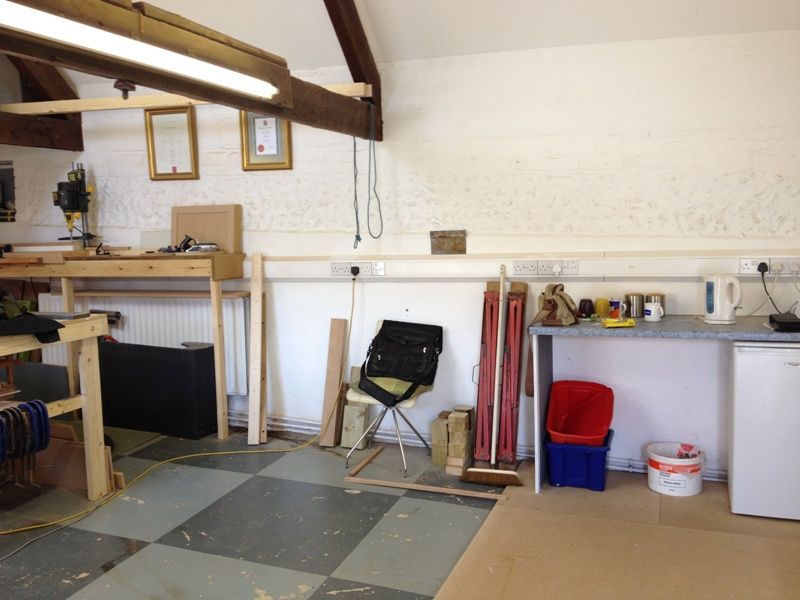

I've been in the shop today and taken a couple of pics of where the Rayburn is going live.
Pretty much where the chair is...

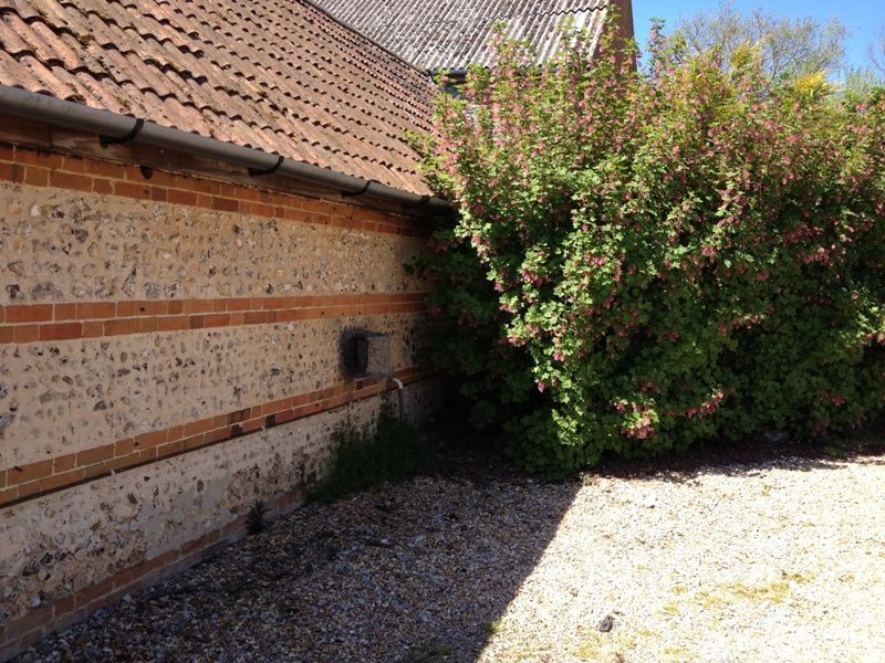

The outside might be interesting with a flue behind all that growth. I'll have to cut it back a bit. Although, there is a space on the other side of the hedge, which is where the oil tank is situated.
The plan is to make a formwork concrete plinth and the flue will elbow out through the wall and then up just above the roof line with a cap on it.
If anyone can see potential issues or perhaps a better plan, please share.
Cheers. 8-)

Postby mark270981 » Mon May 06, 2013 7:58 pm
Your space and outside space looks ace.
Is that home? Or rented?

You will need to check how high the flue needs to be because I think they recommend it to be higher than the roof ridge.

Hi Mark and thanks. Yep, I rent the shop which is on a farm and only a few miles down the lane from home. It's a great little set up - the old buildings are former stables which now form a courtyard of various workshops including me (woody stuff) an upholsterer, locksmith, picture framer, jewellery maker and a few others...

woodsmith wrote:You will need to check how high the flue needs to be because I think they recommend it to be higher than the roof ridge.
Yep nice one... I'm going to research this. I think this depends on opening roof windows (dormer or velux type) and as there aren't any on this side of the roof, I'm hoping I only need to go about 900mm above the fascia line. I'll check it out.
When we looked into having an oil Aga I think they wanted it to be 14 ft above the stove to ensure it would "draw" which would have put it high above the roofline. There is a downdraft effect at the eaves which means you have to put the flue well up into the air. You will normally need to tie it into the roof with steel rods to keep it stable.

http://www.stovesonline.co.uk/flue-outlet-height.html
