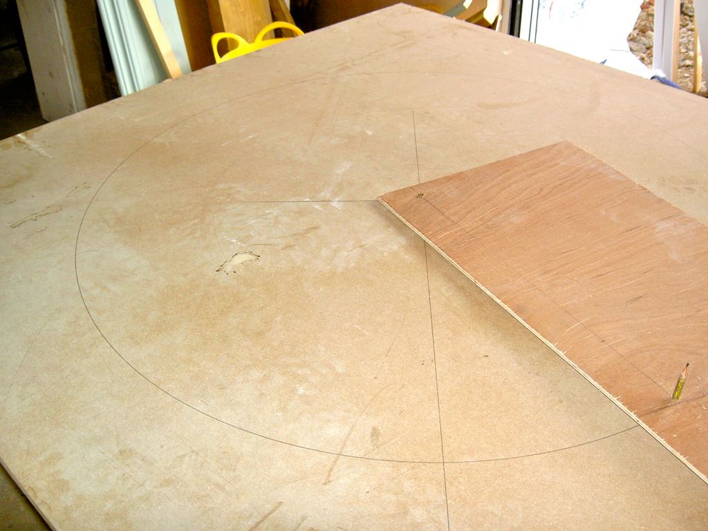

Marking out the circle on some spare 18mm MDF using a piece of thin ply a screw for the centre and a pencil to mark out with. I used a bush as a guide so reduced the template circle to accommodate the clerance between the bush and router cutter.

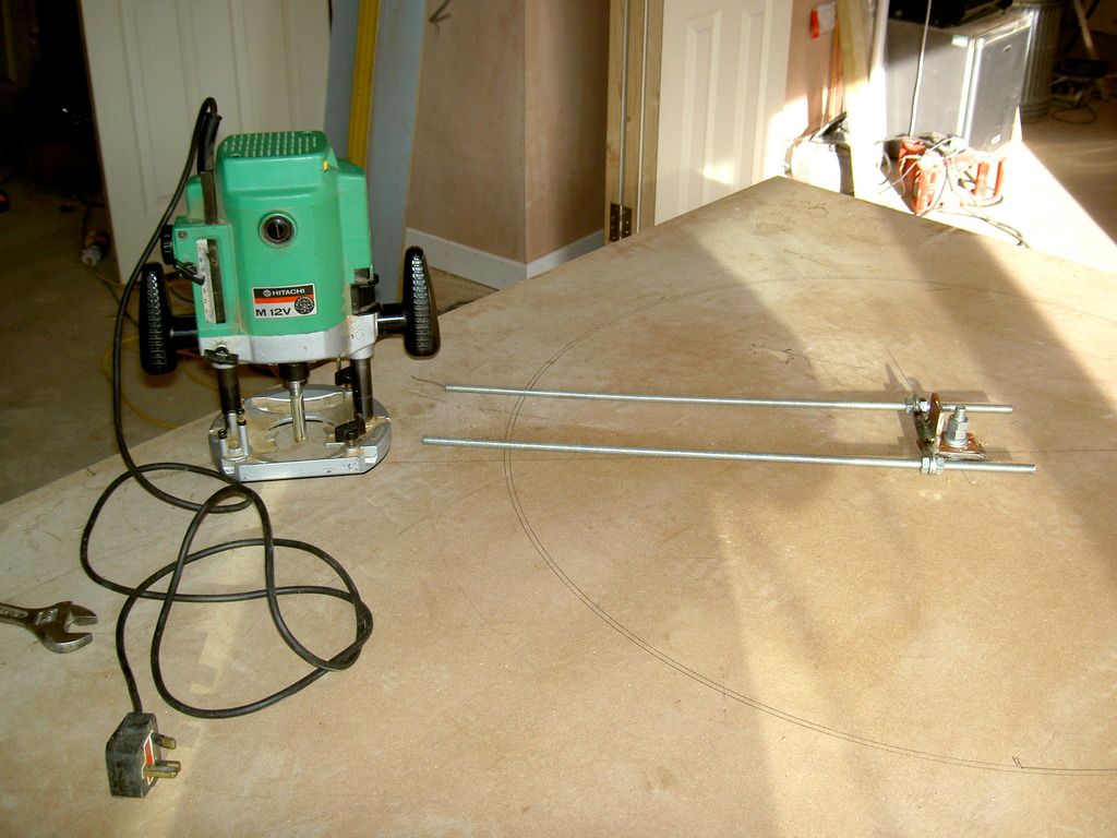

After marking out the circle I used a router + trammel to cut a template for the circle using the MDF.

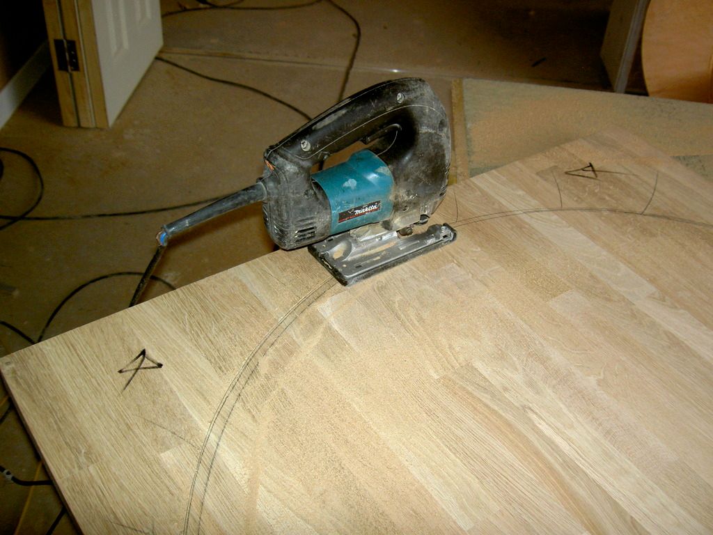

The MDF template was then used to mark the top of the oak worktop allowing it to be slightly over size for trimming. I cut the worktop using a jigsaw.

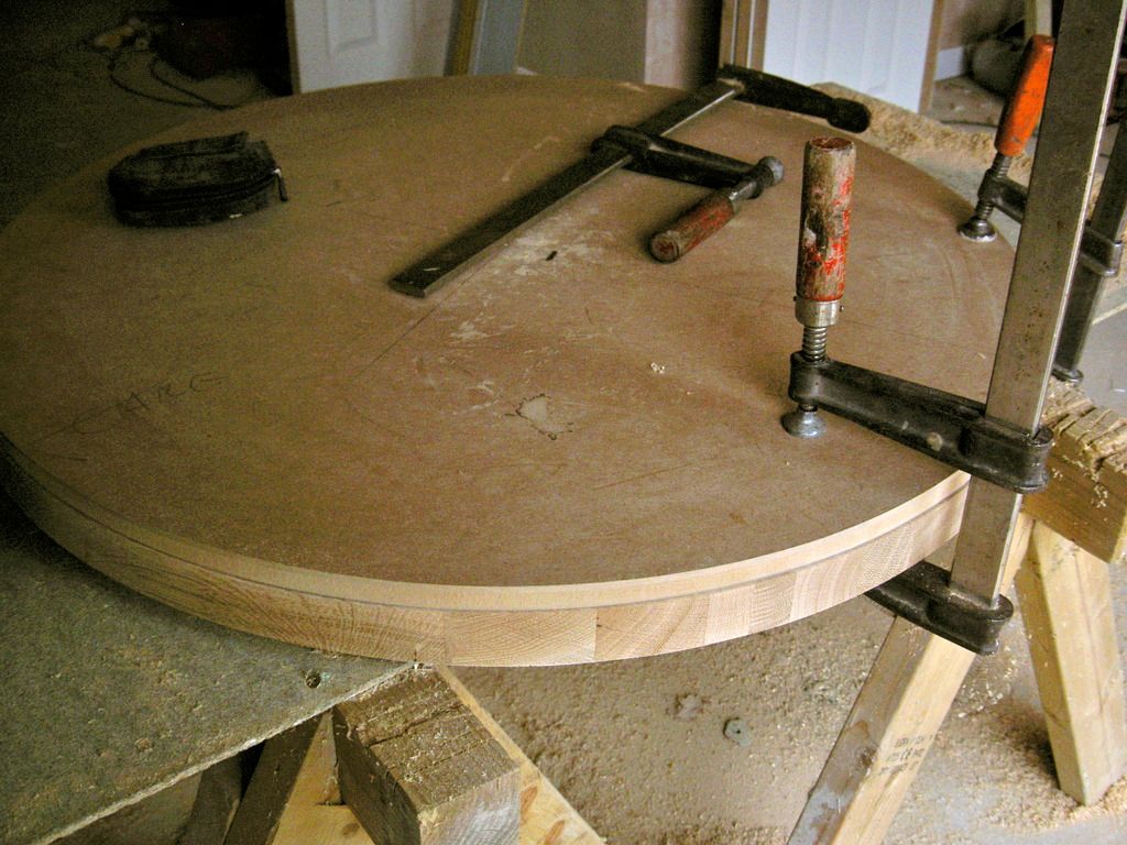

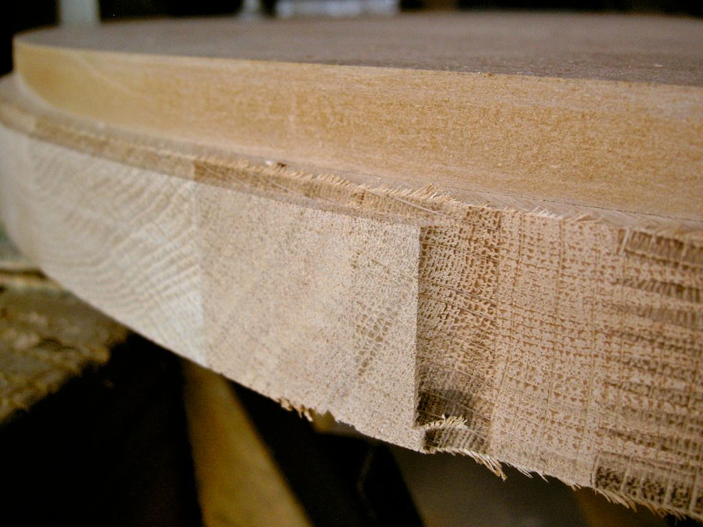

I used clamps to hold the MDF template to the oak worktop for routing. Moving and re-positioning the clamps after I had finished all sections. If you look close at the edge you will see where I had the clamp and have just started to route a shallow section at the top of the worktop.
This picture shows how I first performed a light cut in the top of the worktop to prevent breakout. Each cut was made about 6mm deep until I had cut through to the bottom.

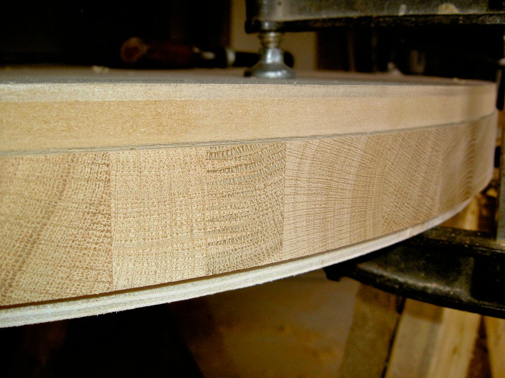

The worktop finished
And a close up of the edge.
Many thank's to all who added suggestions. This job was done for a main contractor who supplied materials and router bits. I would use a Shear bit with two bearings next time as this was suggested by a member of the forum and I could see the obvious benefits after using a plain cutter with bush.
