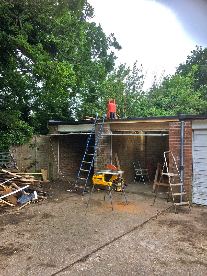

Just thought I'd update this post with a few pictures which might be of interest to some.

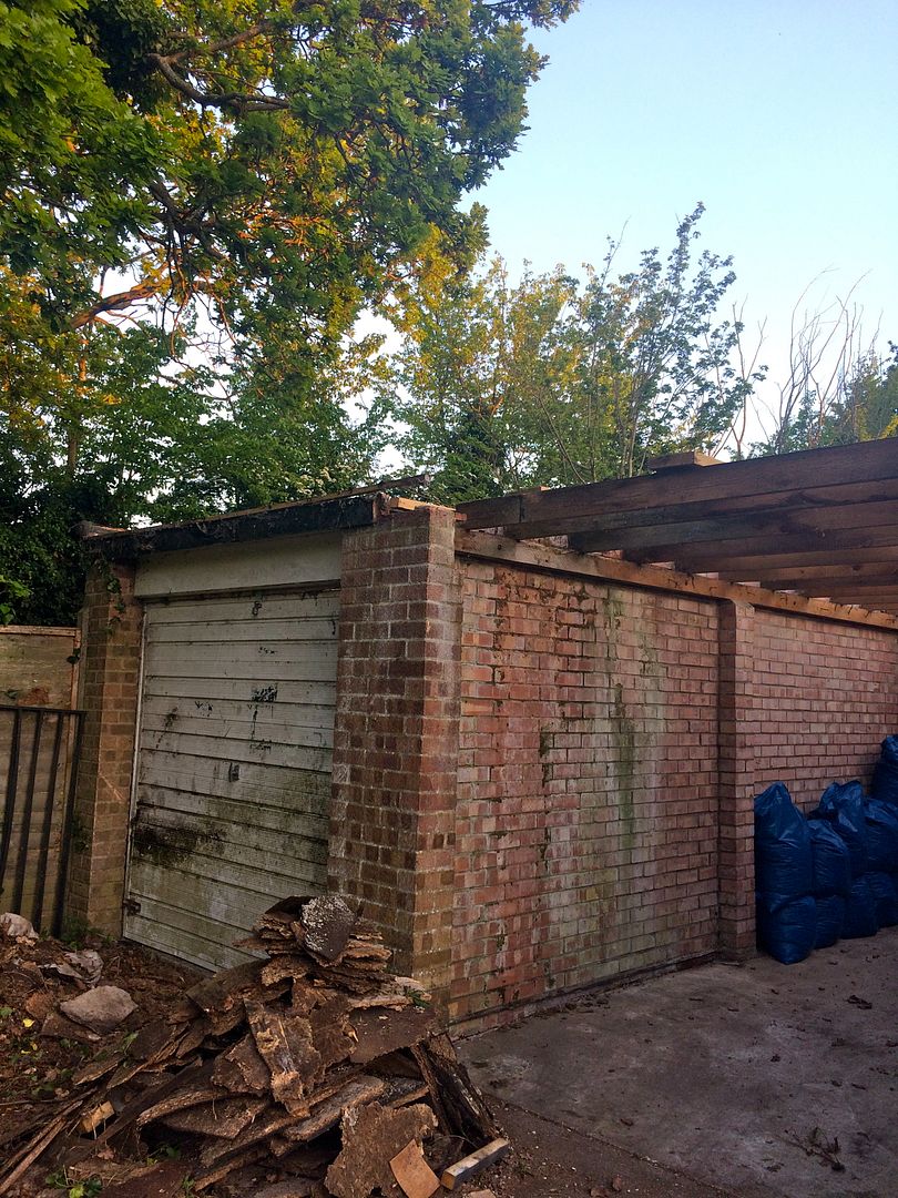

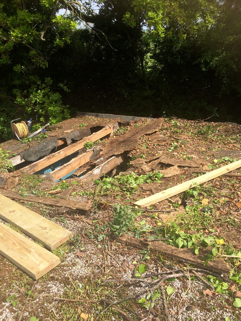

Quite a hole!

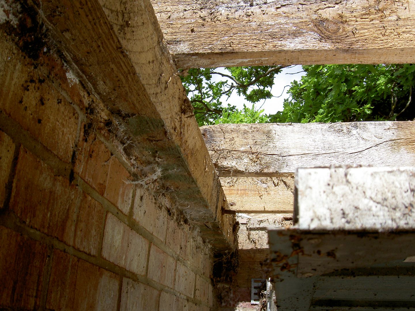

Some of the rotten roof timbers
More holes
Some rafters needed replacing.

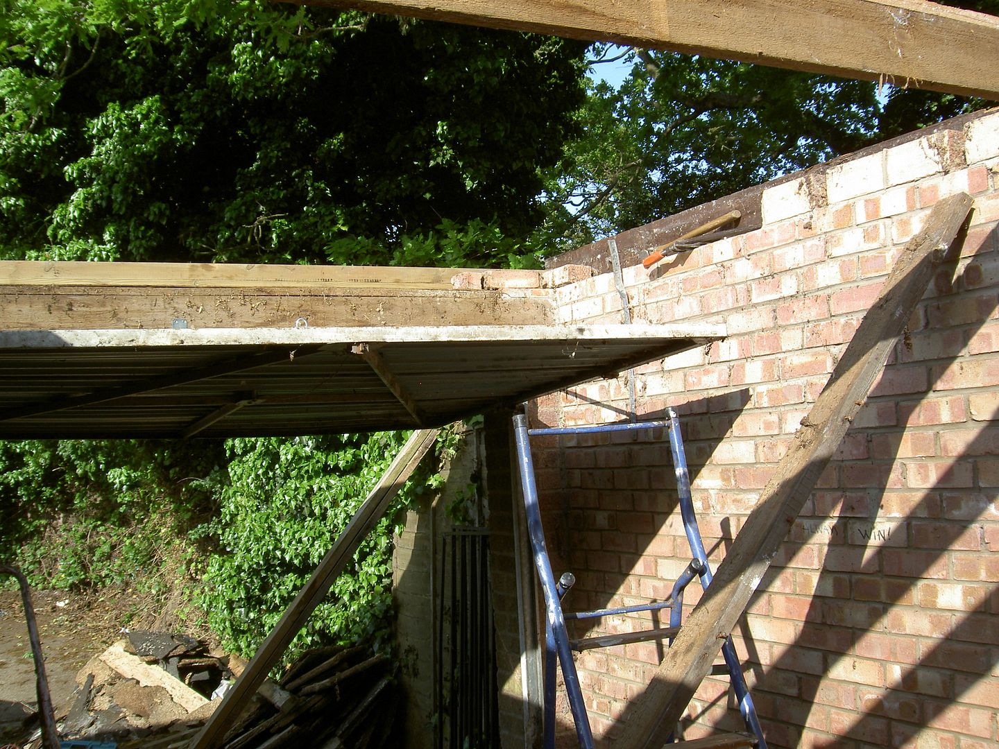

The timber supporting the garage door had completely rotten on this garage.

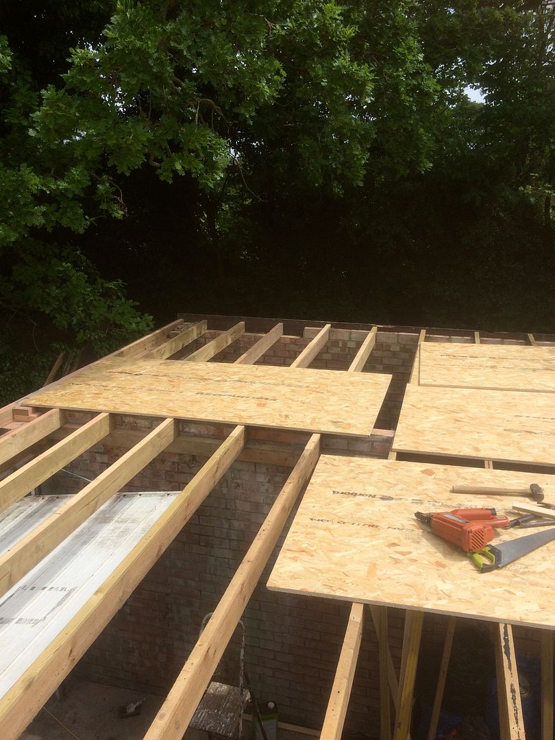

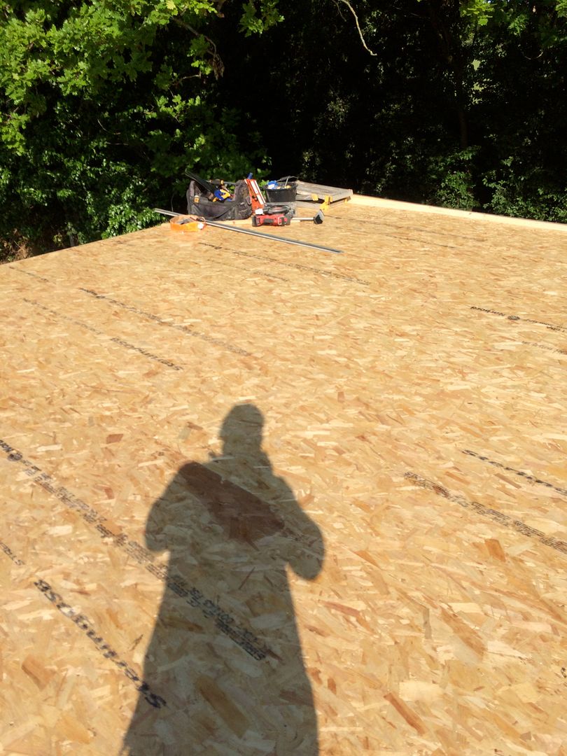

New timbers in place and re-boarding using OSB3 Sheeting.
All ready for the torch on felt.

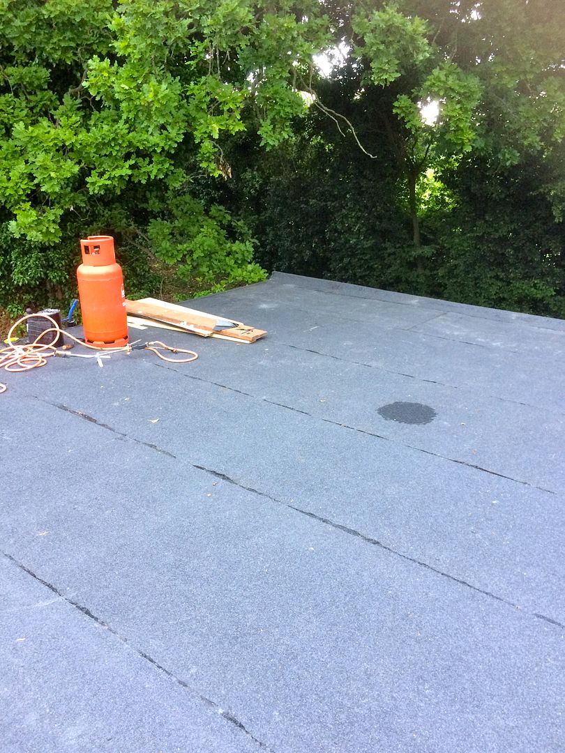

Felting started

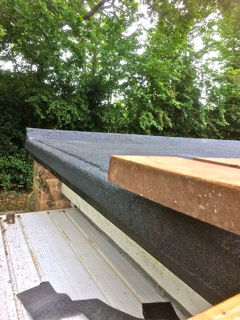

Front drip
Top view of felt capsheet.

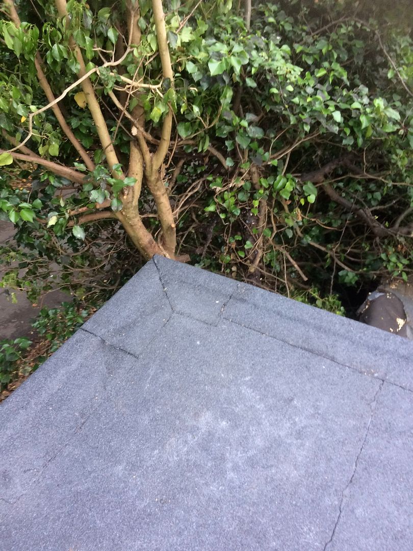

Corner detail which I should have made line up a bit better (I will remember this!!!).
Had a few stormy days since this was finished and all watertight.
