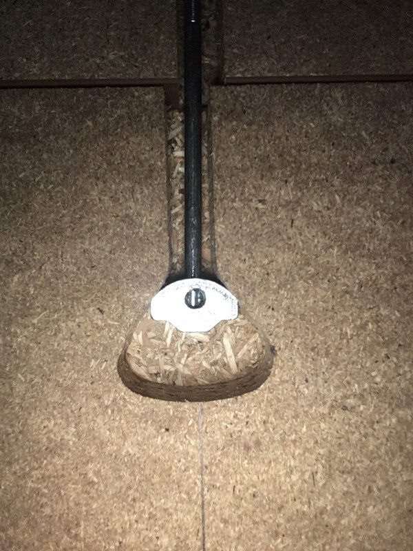

Theres this funny looking thing under the surface I guess pulling it against the adjacent surface?

Yes, that's a (badly installed) worktop bolt. The other end (the top in your pic) will have a nut on it which you loosen to remove the bolt. However the two bits of worktop will be joined with some kind of sealant as well - usually like a thick PVA glue. You will need to carefully break the joint. Water will dissolve the glue, but unfortunately won't do the worktop much good at the same time. Start by undoing the bolt(s) and see how much movement this allows. You may then be able to cut / pry the pieces apart.
The new piece will need a similar slot and mushroom shape putting in with a router. You can get a jig, or you can (carefully) do it freehand, if you have access to a router.

Completely standard worktop clamp and readily available.

Actually it looks like a zip bolt, in which case you undo it with a hex key at the end you photographed.

Ah, OK. It unscrews, anyway :)
