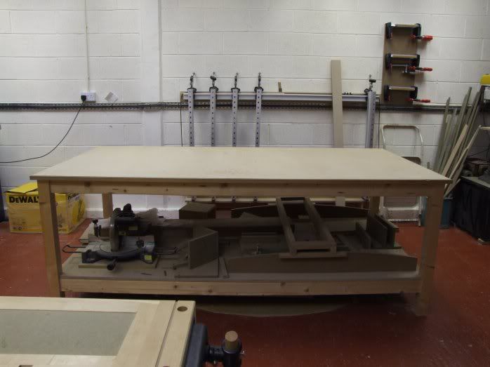

OryxDesign wrote:....... it is a torsion box made from mfmdf. I've been using it for about 6 years and I wish I'd made more of an effort to make it flat (i'm not sure where I went wrong :oops: ), it has a slightly convex top which can be a pain when trying to hold a long board on it's edge.
Cheers Si
Er hate to say it but maybe you'd be better off without it? I did wonder about how you keep a 'torsion box' flat anyway. It's such a strong structure that I imagine differential heat, humidity etc will send it off a bit.
Ultimately it's down to the eyeball. I'd most likely lay 2no 2x4' s over the bench or saw stools and eyeball them for level, which has been mentioned before. Or a piece of mdf dropped on the bench top.

It's stable to be fair, otherwise it might have sagged straight. It has my edgebander in it and I would make another one very similar if I needed to. It isn't the kind of bench I'd make for joinery or hand work though.

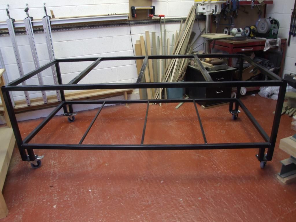

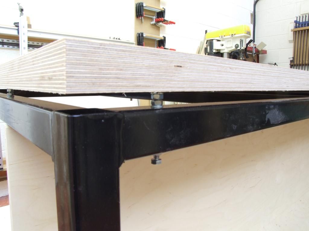

Probably a bit OTT for what you have in mind but I thought I would weigh in on the side of the 'flat is best'. I was going to publish a WIP etc. when I finished this but it's not done yet after two years :oops:
I noticed that I was spending a large proportion of my time at this bench:
Just an MDF top on a softwood frame which sagged enormously, causing all sorts of problems. I just decided, since it played such a big role, it was worth spending a bit of time and money on.
I got this firm to make a steel frame. http://steelyproducts.co.uk/Products.php" onclick="window.open(this.href);return false; About £300 which I didn't think was bad for a totaly bespoke item, powder coated (in a choice of colours) and on heavy duty wheels. I got them to put the stretcher at a height so I can wheel my veneer press underneath.
When the firm make packing tables, etc., they just screw a sheet of MFC to the frame. Obviously, it isn't precision engineering. What I did was to open the holes to allow machine screws through. A sheet of 38mm birch ply was added (not much change from £100 :shock: ) which I marked up and inserted threaded inserts to the underside. This is then supported from the frame in a 'jack screw' principle which can be tuned up as flat as you like. It isn't an engineer's surface table but it isn't far from it. How's that for obsessive?
I don't recall ever seeing this solution to a bench before so I thought I would share it at this point. On my 'proper' bench, I just give it a skim with number 7 every so often but on an 8' x 4' I don't see this as being practical so I came up with this instead.
It's going to have clamps hung from brackets, three cab's with drawers for abrasives, fixings, glue, etc., maple lipping to the top with threaded inserts for jigs, etc., etc., etc. All at that ideal time in the future, of course. :lol: Meanwhile, it is one of the best investments I have made and a pleasure to use.
