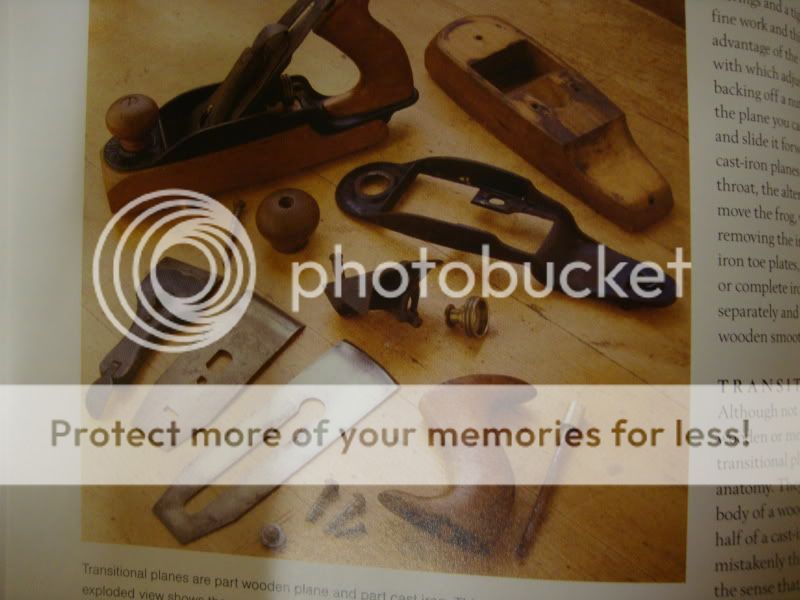

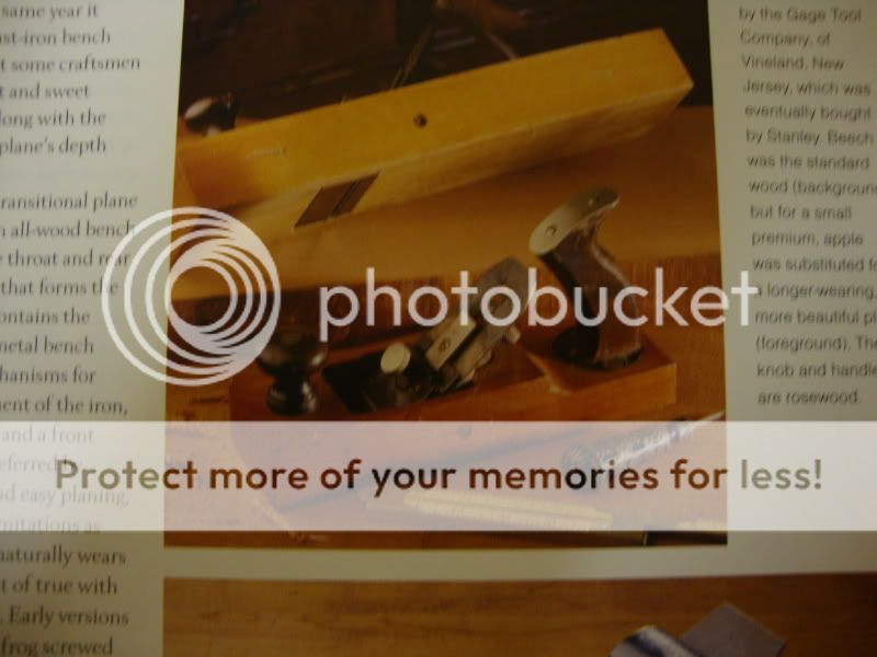

PS, I've seen the Plane Paul is describing, might have a picture.......
mtr1
Posts: 959
Joined: Tue Sep 22, 2009 6:00 pm
Location: North Norfolk
Re: Experimenting with the Grimsdale method
Postby mtr1 » Fri Apr 30, 2010 9:01 pm
I think this is What Paul was describing possibly?
Oh and I found this pic of a Roman one.

Postby mrgrimsdale » Fri Apr 30, 2010 9:26 pm
mtr1 wrote:I think this is What Paul was describing possibly?....
There seems to have been lots of intermediate wood/steel plane designs from a long way back, like your pictures, and modernish ones like this:
but I guess they never caught on in a big way.
