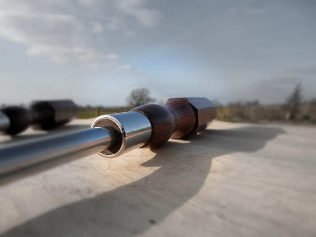

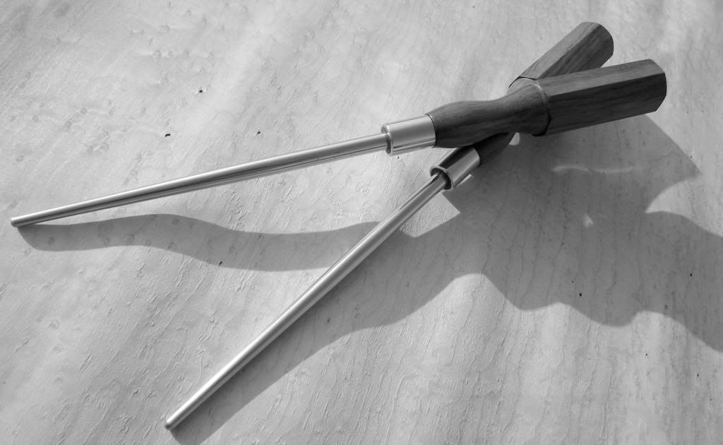

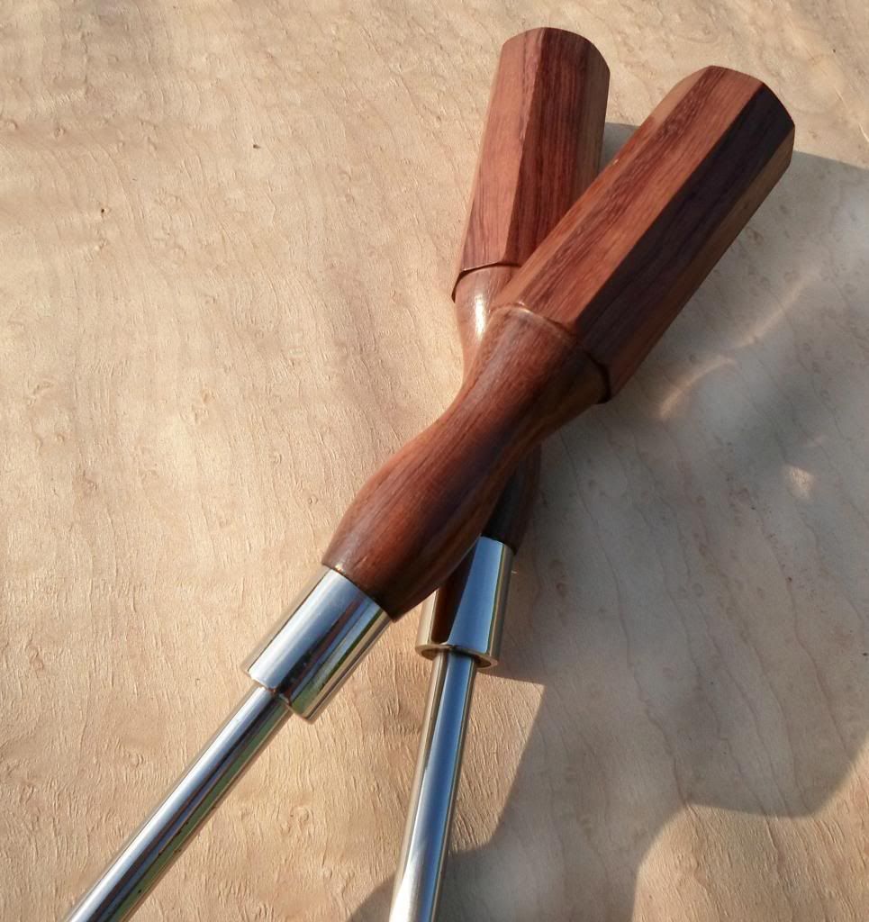

As some of you may know, I not only make kitchens and stuff, but also tools.
I recently had a customer ask for some Drawbore Pins, so made these
London pattern-esque Bubinga handles, stainless steel furrules and hardened silver steel pins.
Thanks for looking.
Adam.

jake wrote:They are pretty. Did you turn them (the tapers) off center?
The trad ones in my tool chest are all iron/steel and are very mangled at the ends nonetheless. Yours look far too pretty for such abuse but are no doubt destined for more delicate work.
The tapers are turned (on my lathe) by swivelling the headstock and offsetting the tailstock. I have an old (WW2 era) Barker lathe which has this unusual feature (the swivelling headstock).
I must get around to building myself a taper turning attachment as it's a faff to accurately line up the centres again using a Dti.
At 9.5mm, these are more for furniture sized joints rather than framing joints. I will be making some 1/4" and 1/2" ones too.
Thanks for the interest.
Adam.

riley wrote:Yeah, they're plain tapers.
I've used both plain and eccentric in the past and to be honest, I find the eccentricity unnecessary.
Adam
Hi Adam,
There is a case for offset/eccentric pins in some instances, normally on a deep component such as a newel in the situation where the offset hole in the tenon is a tad too close to the shoulder and difficult to pick up.
A standard taper pin often has to be angled to engage it and can crush and deform the hole so that the round dowel is in an oval hole.
No problem on painted work as a bit of filler will sort, but on polished stuff it will stand out.
An eccentric pin will pick up the hole easier without having to tilt it and crush the wall of the dowel hole as the stright side can slide down the wall of the dowel hole and pick up the tenon, leaving a neater finish.
At least, that's how I was shown at college anyway! ;)
On thinner components there's maybe no necessity for eccentric pins but they are out there second hand if you can find them, the college had a few sets of lovely old boxwood handled ones - Marples as I recall. They recommended them over standard taper pins for that reason if you felt the need to own any, although even then they were a specialist tool for most people's kit; a couple of joinery shops I worked in had their own pins, as did a couple of the older joiners working there, but they were usually the ones who specialised in more complex stairs and went out on site fitting them.
Cost wise, I think I remember seeing them sold at around £20-25 per pair back in 1977, so yours are dirt cheap!!!
Edit: Forgot to add, the offset taper allows you to twist the pin once it engages and tighten the joint; maybe a couple of taps to nip it, then twist it back to release the pressure when needed. As I recall, the pins we used pretty big handles, I guess to give good purchase for twisting.

Andy, thanks for the extra information. At 3/8" I cant see these being used on anything needing anywhere near as much force as pulling a newel post joint would need, hence the simpler (and FAR easier to machine) plain taper.
Might have a go at an eccentric taper for some 1/2" ones.
As for the price, I don't expect I can command a premium like Ray Iles or Lie Nielsen (yet!), especially as many of the tools I make at the moment wouldn't form part of a 'basic' toolkit.
