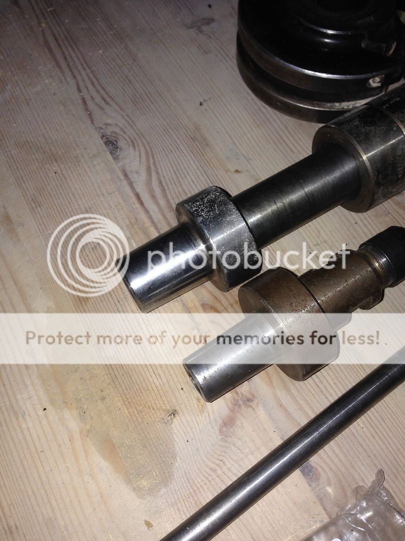

I got this manual and it appears from the manual and what the man from Sedgwick said that the spindle is just mounted on a shaft by friction
I cannot remove this thing for love nor money
Anyone got any ideas ??? I've tried levering it off, pulling it ,jacking it off with car jack , praising it off with tyre levels ,

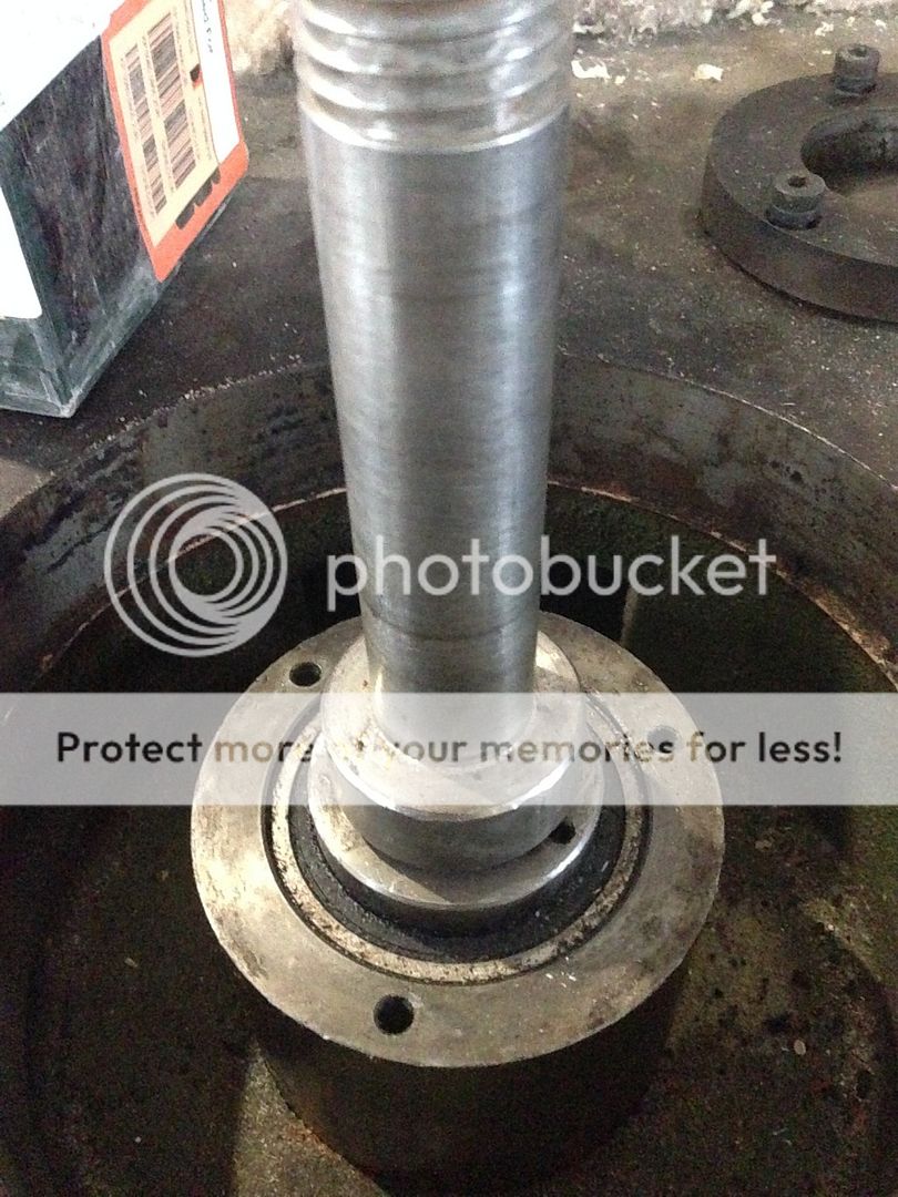

I can take the pulley wheel (which is at the base of the main shaft) off but that won't release the top bit which is a "loose spindle" which sits on top of the main spindle.
John - I did heat it and used 1/2 can of gas in my plumbing blow torch and it did bugger all, its thick steel so perhaps a plumbing blow torch not man enough. I can get another bottle of gas and try that again if you think thats a goer.

On top of the shaft in the above piccy is that the lock nut thread i can see or is there a thread inside the shaft with a locking rod, also what is the diameter of the flange on the bottom of the shaft ? i have an idea you can call or i can try and get that across on here.

If you click the picture it will open my photo bucket and I have taken a few pics of manual
There is a collet with two holes in it which does look like a locking pin . I can't get this free either though and man from Sedgwick says this does not release spindle
I think man from Sedgwick could be wrong . Ang ideas how to get locking collet free ? I modified an angle grinder blade changing tool and that wouldn't move it. Also tried hammering it off with a drift.

ITS DONE ! Im very happy.
I phoned Jon who suggested putting the block on and tightening it against a piece of tube against the top of the bearing then whacking the bolt from underneath too. I did that and it worked.
Jon you are the hero of the day !
The router spindle I have doesn't bloody fit though after all that and is too small, so going to get a engineering place to make me a bush for it. I cant be defeated especially not after all the agro I've had with this.
