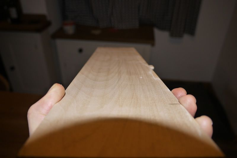

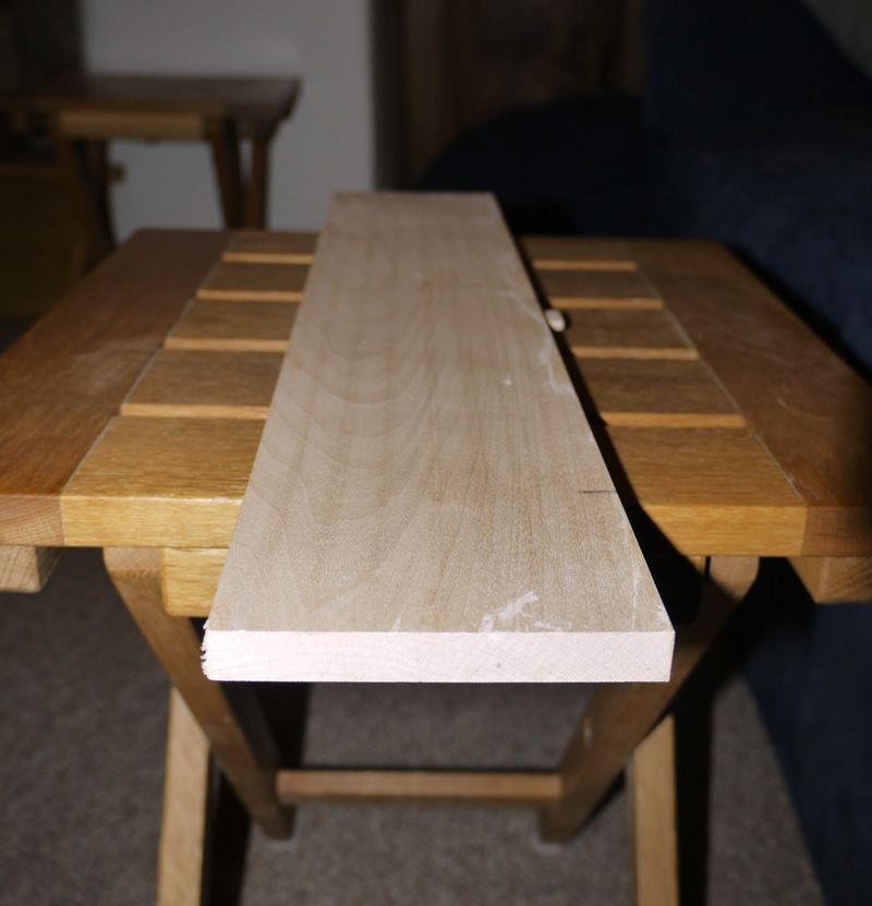

We've got a Felder engineer coming next week with a new set of blades. I'm not convinced this is the problem and wonder if, as others have suggested, we've got a faulty block..
I'm hoping they don't try and say this is within acceptable tolerances..
Here's some images of what we're getting - am I being fussy??
As Nick and Mike suggest (if i understand correctly) the path of the 2 cutter rows should overlap and hence with an accurately milled block the machining lines should cancel each other out or at least be narrower and much less noticable..
Doug, your engineer friends input might well be helpful - thanks..
Tim

Postby karl » Wed Feb 13, 2013 12:05 pm
That doesn't look acceptable to me - have Hammer/Felder seen those pics?

I get better finish from a 2 blade lunchbox model. Unacceptable. Hope you get it sorted.
Re: Hammer
Postby Mr Ed » Wed Feb 13, 2013 1:14 pm
The pic with the square says it all, that can't be right.

Tim
Then it must be a problem with the actual cutter head as it would appear from Dougs photos that the two helix's are machined in such a way that the cutters overlap each other.
That's the conclusion I came to
