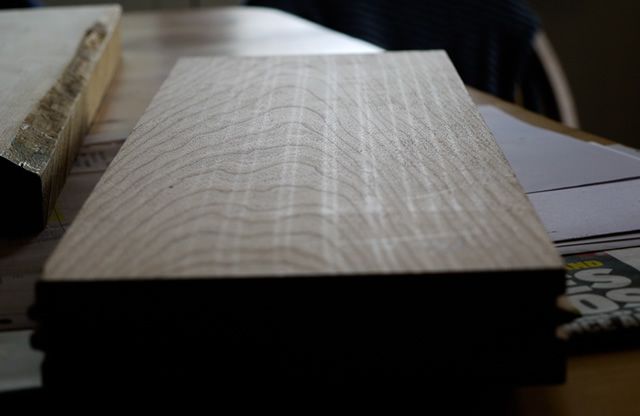

Looking at your photo Tim each scallop looks to be the width of a tip.
If you look at these photos you can see that the tips are offset on either row by about half a tip width, on the first photo the tip is about half a tip away from the edge of the block, in the second about one tip from the edge.
So I would expect any scallop to be only half a tips width, yours look wider which suggest to me that only one set of your tips are cutting ?

Re: Hammer
Postby timbly » Fri Feb 15, 2013 6:18 pm
Hi all
Thanks for the continued interest.
An engineer is coming out next week.
After sending them the same images that we shared here we recieved an email from Austria stating;
"A light wavey surface is allowed, but we will have to check this on your timber. So the engineer will do this when he is at your workshop"
What they classify as "a slight wavey surface" is anyones guess but the responses I've had here would suggest our results fall outside most folks definition of slight..
Hopefully next weeks visit will see a speedy resolution to our problems.
Tim

I can't help wondering if spiral blocks are just a way to flog large numbers of carbide inserts.
As Ed says the surface form a conventional block is bound to have some fine scalloping and intermittent cuts will be noisier.
Breaking up the blade into a number of section and then forming them into a spiral to get over the problems straight lines would cause seems counter intuitive and the result is swapping one sort of scalloping for another however fine.
It will be interesting to see how much they wriggle and fight on this one.

9fingers wrote:I can't help wondering if spiral blocks are just a way to flog large numbers of carbide inserts.
As Ed says the surface form a conventional block is bound to have some fine scalloping ......
Yes but they diminish to nothing with faster block and slower feed. Whereas the inserts are not set parallel to the cutter axis and can't cut a flat surface at any speed, by definition. So perhaps it's a question of good enough, or not?

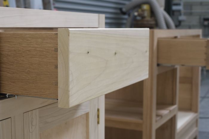

Following a visit from a pleasant Felder engineer who was with us for several hours measuring everything and swapping blades in and out.. The bottom line was he couldn't really find any reason for the results we've been getting although he agreed they were definitely unacceptable. Strangely when he swapped the cutters out for a new set the cut was markedly even worse. The fact that the cut was worse with a replacement set was slightly worrying and suggested that the blade sets are possibly not machined exactly identical.
Here’s a pic taken recently of a piece currently under construction – the machining lines as left by our Silent Power block are clearly visible in the Tulip wood drawer front..
The powers that be in Milton Keynes are prepared to swap the machine for a new one although we'll have to wait until the end of March for a new one to be built. They haven’t got a 16" temporary replacement in stock so we decided to stick with ours until the new one is built.
We've tried to get assurances from Felder that the Silent Power is as good as advertised before choosing whether to get the replacement with the spiral or standard block. On March 4th we had a chat with a guy in Austria. After receiving a piece of wood which had been machined on our PT during the engineers visit as mentioned above he was of the opinion that our cut was outside acceptable tolerances on two small areas of the board only! Bit surprised by this as we considered the cut unacceptable across the width of the block - I leave you to make your own conclusions..
..but I guess from our point of view the bottom line is he agrees that the machine should be replaced.
The current deal is that they will deliver both a standard and spiral block machine to Milton Keynes. We will then make a 9 hour round trip to try both before making the final decision as to whether replace our current unit with either the demonstrated spiral or standard block..
Hopefully we will eventually get a satisfactory conclusion and we will be able to post a positive review of the A3 41 and the Silent Power block.
We are in discussions for a reasonable compensation so watch this space…

Postby timbly » Fri Apr 26, 2013 4:16 pm
Hi all
Went up to Milton keynes several weeks ago to try out a possible replacement Hammer A3 41 machine with the Silent Power block.
The results while definitely an improvement on our original machine were not perfect..
Our conclusion is that some form of the scallop effect running the length of the board is a necessary side effect of this technology. It is the extent of these scallop/striations and the effect on your working practice that is relevant.
As you can see from the above picture of some cherry we machined on the new possible replacement machine whilst at felder HQ the striation pattern varies across the board. On the right, the lines are evenly spaced at half a cutter head width - this in my opinion demonstrates a perfectly engineered section of block. To the centre and left the striation pattern varies and while the spacing is not the width of each individual cutter head as with our original machine neither is the spacing representative of a perfectly engineered block. The above pattern is within Felder acceptable tolerances and i guess demonstrates that the machining tolerances are so exacting that a completely best possible cut from the technology is difficult to engineer.
I suppose the bottom line is what is acceptable for each user. For a joinery shop running thousands of board foot then the advantages of quietness and little breakout (note; you still do get some breakout and in our experience you can't just run boards without any consideration to grain direction) possibly outweigh the downside of the scallop lines. For a one man band cabinet maker running far less board foot and wanting an initial cleaner finish then perhaps that equation is reversed..
As stated in an earlier post the best possible solution is probably a standard 4 knife tersa block with variable feed speed - unfortunately our current finances do not run to this…
Following our visit we had the choice of replacing our original machine with the demonstrated spiral block or with a new standard block machine. We eventually decided to replace the Silent Power with a standard block machine. This was delivered this week and seems to give an excellent cut. It is a lot noisier though.
We would not necessarily rule out the Silent Power block if we upgrade in the future but would need to consider our requirements at that time..
Other than a few early hiccups Felder have been good to deal with. They offered a fair compensation and have been helpful throughout.
Tim
