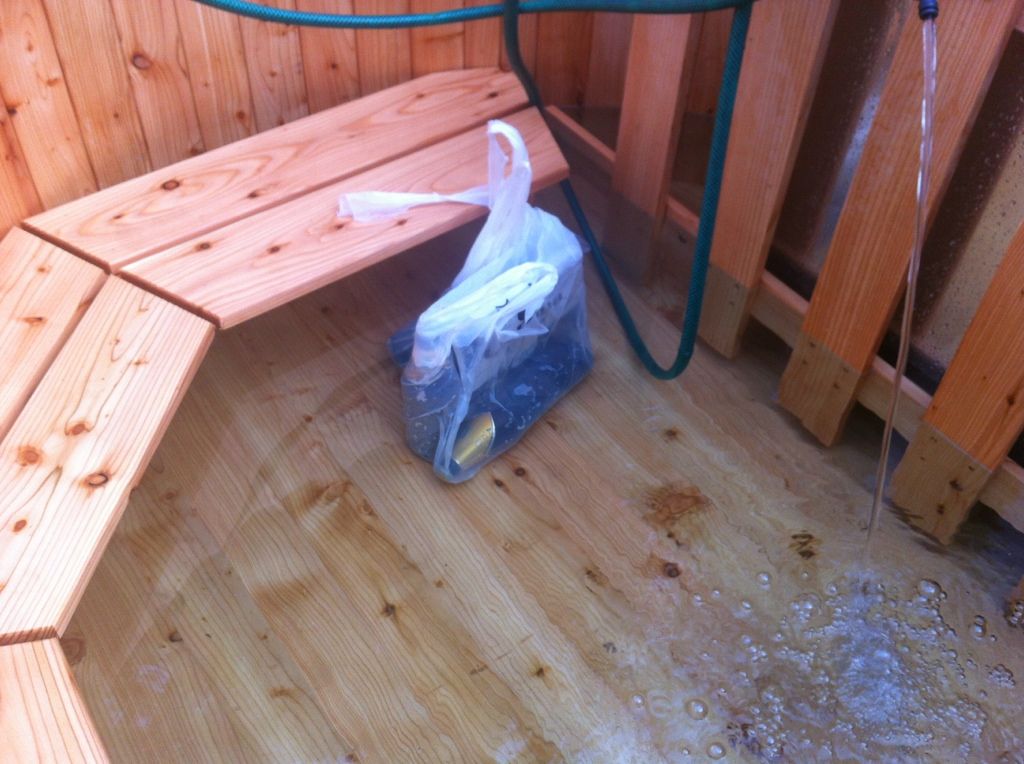

Had a few bits to finish of in the workshop some galvanised support brackets were coach screwed to the sides to take the seating and the burner was bolted to the side of the tub.
Got some muscle in to load onto my trailer was too heavy to lift so was rolled .
A guard was made for the woodburner and in this pic you can see the finished seating as well
Filling started and there were a few leaks from the bottom but only slight. As the cold water went in it kept the beers cold.
It took about 3 hours to fill and get to 35 degrees.
In use
A bit of over exuberant use of the wood burner meant the water got up to a toasty 48 degrees. Overnight a spare sheet of celotox insulation was put over and it was still very hot in the morning. Leaks are now a minimum about 10mm of depth lost over night.
