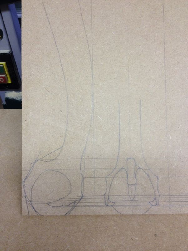

This afternoon, I've prepared some full size drawing details for the desk. The leg detail will also be the actual template.
I'm ordering the timber etc on Monday and hope to start very soon.

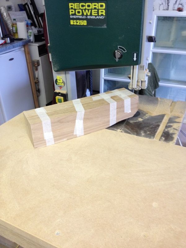

I've spent a bit of time on the band saw this afternoon in preparation of starting this project. I've extended the table using MDF and oak. It now feel much more stable when feeding longer & larger pieces of timber.
Here's the newly extended table off as I'm about to change the blade - it took 1 minute to remove.
Here's the underside of the table.
And the top side...
I had to form a shallow rebate because the saw's table is 21mm and the MDF is 19mm. I used the existing wing nut bolts into the existing threaded holes.
And now the new blade is in the machine and new extended table in place ready for work.

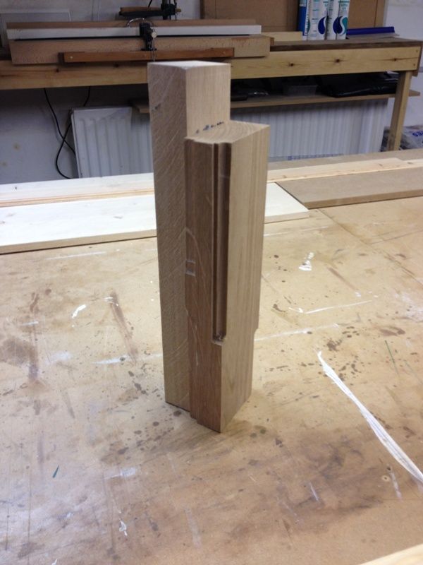

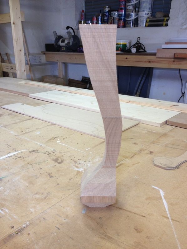

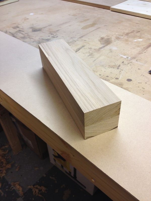

But today, I had a couple of hours to spare late this afternoon and as I haven't carved a ball & claw foot for some time, I thought I had have a practice on some oak. Also, the ball & claw foot I'm hoping to achieve isn't the conventional type - as some of you may have noticed by the workshop drawing. This is also when I noticed an error today :?
I glued up a couple of oak off cuts the other day to use as a trial run piece before I started the actual work.
Out of clamps...
And cleaned up to 88mm square.

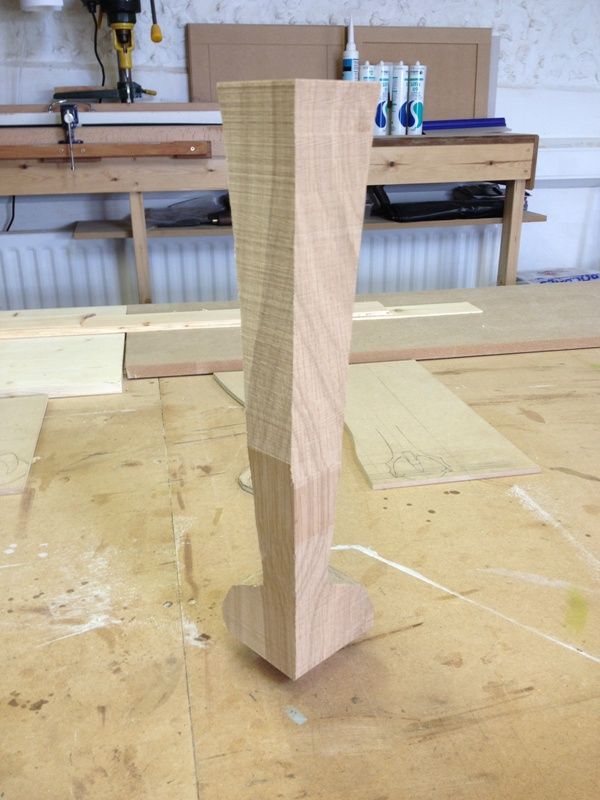

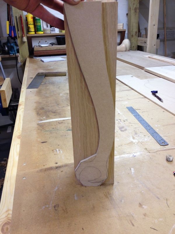

Here, I sketched another foot very similar to the the job, only scaled to suit the trial run piece of wood. And this is when I noticed the error... I didn't include a top knuckle in the left & right toe.
I amended it here, and this is what I'm hoping the front will look like... roughly.

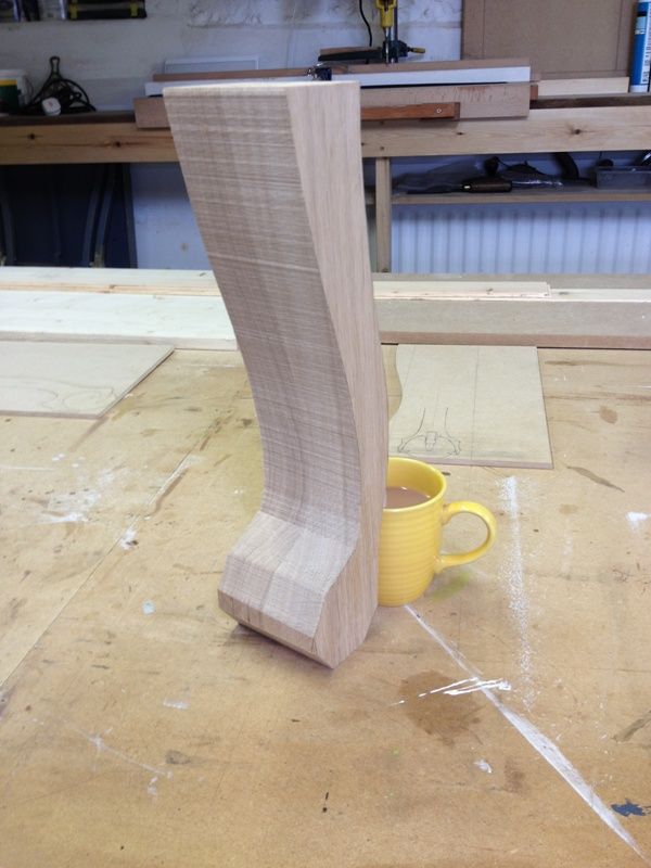

I cut the template and marked it onto the work piece.

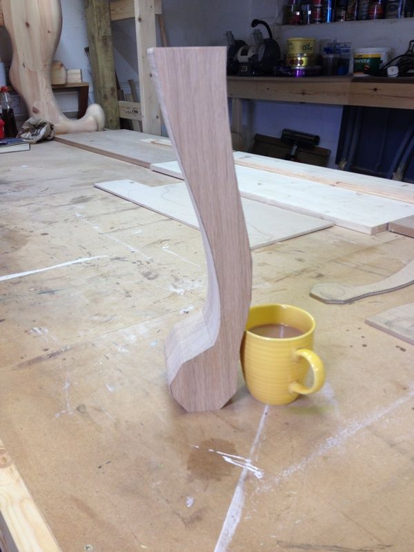

I then made my first cut... NIce cup of tea :D

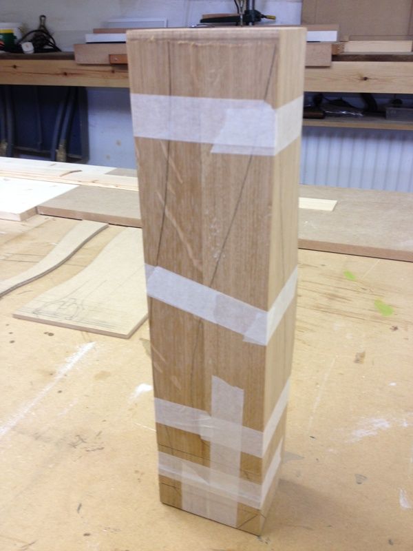

Then, I taped the off cuts back to their original place so I could make my second cut...

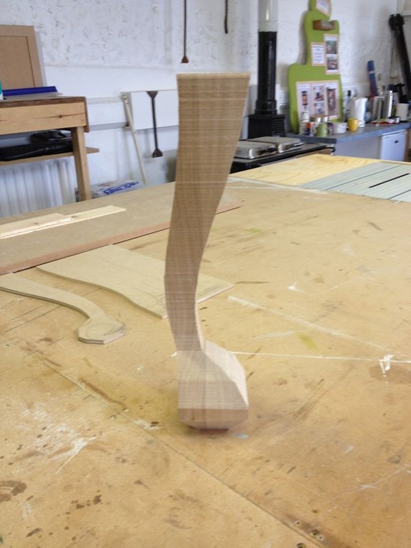

Ready to go... Band saw was great - very pleased.

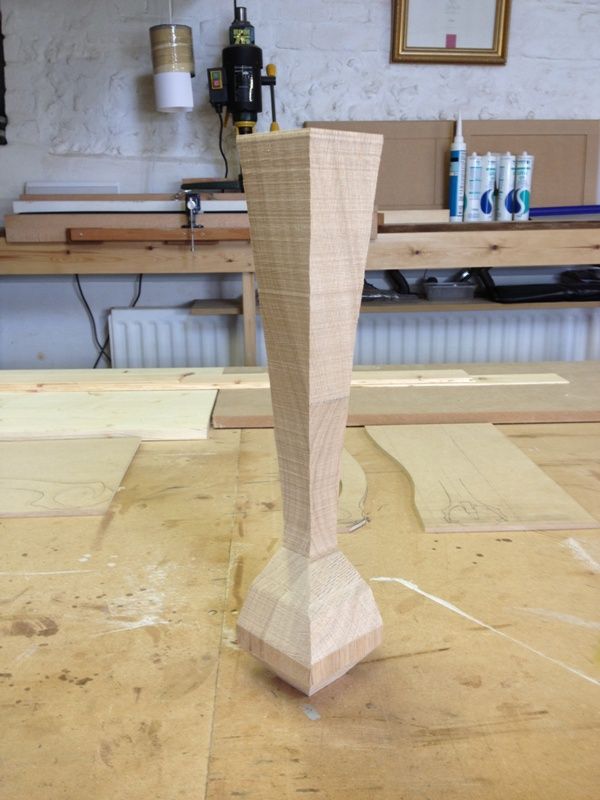

And here's the part leg and foot ready to mark up for carving... Side.
Side.
Front.
Rear.
I'm now hoping to make a start on carving this trial runner tomorrow late afternoon. I'm away Friday and back Sunday - a 70's fancy dress bash in Wales! :D

Fantastic work but I agree it looks a bit more Gothic than elegant.
Pinch
Posts: 896
Joined: Tue Jun 05, 2012 5:40 pm
Location: Milton Abbas, Dorset.
Re: Maple Office Suite
Postby Pinch » Mon Oct 21, 2013 7:33 pm
Thanks Keith, I agree, it does look Gothic - not good. I'm going to amend this when I get the chance and before I start the maple.
George Fisher
Posts: 89
Joined: Sat Nov 05, 2011 4:07 pm
Postby George Fisher » Mon Oct 21, 2013 9:00 pm
Could it be ball and claw feet are inherently gothic. Cabriole legs are more elegant I reckon, but depends if the customer if stuck on the idea of b&c.
Maybe thinner claws with less pronounced knuckles?
Interesting WIP non the less.
Pinch
Posts: 896
Postby Pinch » Mon Oct 21, 2013 9:57 pm
Cheers George.
I might be wrong, but I think the ball and claw foot originates from the Chinese and was meant to represent a dragon's foot clasping a crystal ball. The cabriole leg will be elegant (I have no worries with this), but I wanted to explore with the b&c before I attack the maple. I want to avoid the more classical design because this is fairly common. I think you're right with the knuckles and claws - they need to be thinner which should give a more elegant appearance. I'll start tidying this trial runner up sometime this week and the end result will be mighty fine. 8-)
mcluma
Posts: 152
Joined: Mon Dec 03, 2007 1:20 pm
Postby mcluma » Tue Oct 22, 2013 8:31 am
Still a mighty nice achievement
cerdeira
Posts: 46
Joined: Fri Jan 07, 2011 10:37 am
Location: Near the beach in Portugal
Postby cerdeira » Tue Oct 22, 2013 11:36 am
My opinion doesn't worth much, but I would take a more stylised approach to the ball & claw.
Probably would use the same motif you have on the top of the legs (kind of a shell viewed from top) instead of a realistic claw.
Users browsing this forum: No registered users and 3 guests
