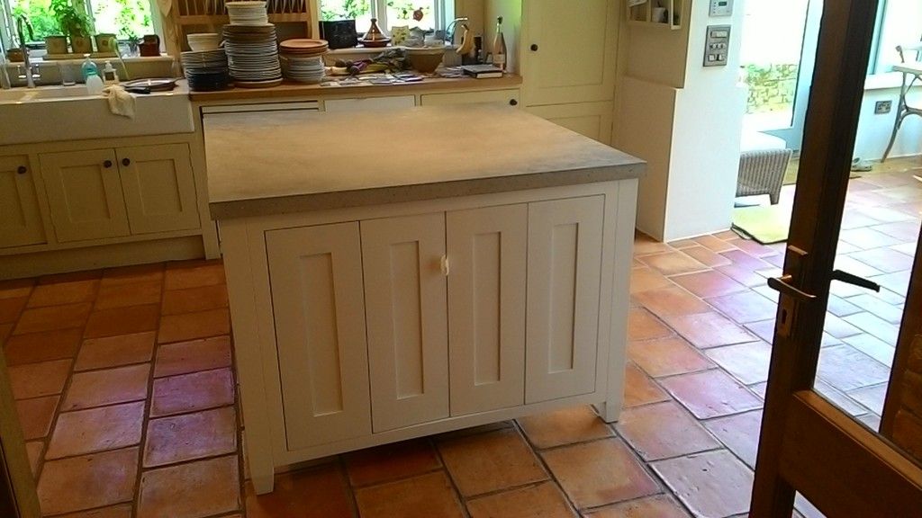

I've attached some pics of a kitchen I made recntly, flakey was the name of the game!
Super plasticisers and loads of vibration when in the mould are your friends. Watch the Vids Mark-Numbers posted.
Just have a go, it's good fun

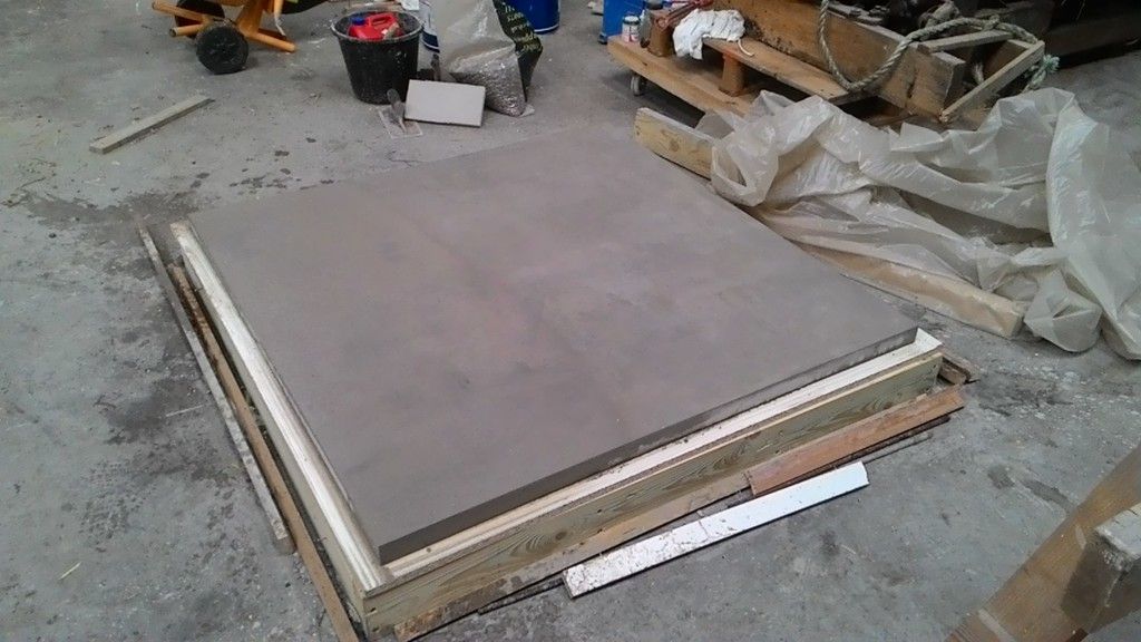

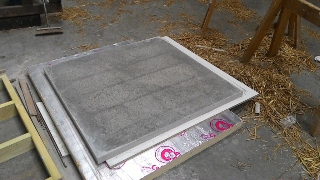

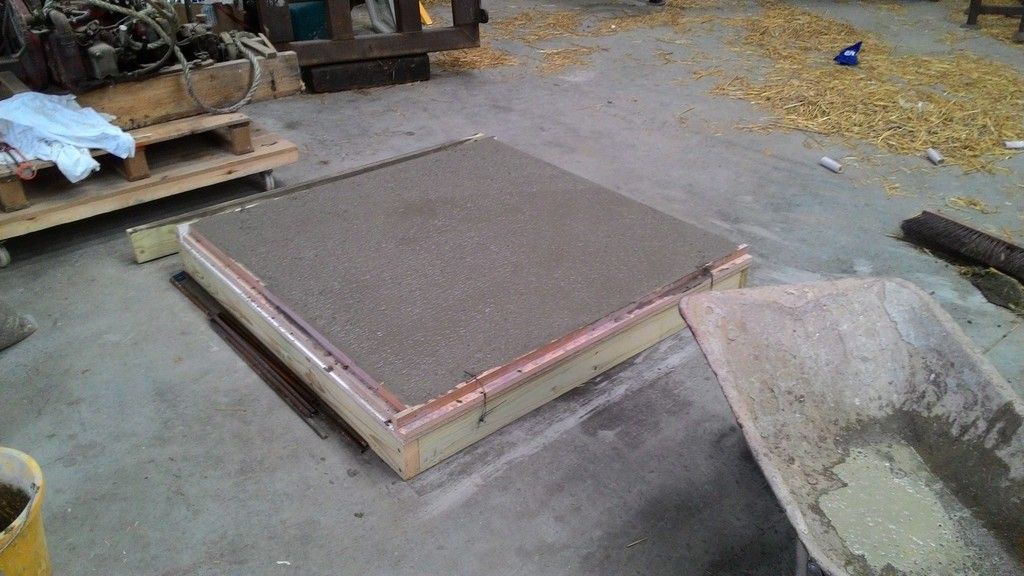

Well... after hours spend on my knees (ahem) she left the shop and is proudly sat atop the island...
All the pics look kinda the same, but since everyone was so helpful, thought the least I could do was post a couple of pics!
Former made from Melamine faced chipboard, on some 6x2"s that I had flattened and screwed into a rigid torsion-box type o' thing...
I had made a grid of rio-rods (12mm diameter) tied on approximately 200mm centres. Dumped about an inch of muck in the former, tamped it like crazy, then floated the reinforcing on this, with some wire tied to the sides to stop it sinking when I gave it a good old shake! Dumped the rest on top to give me circa 50mm of 'depth'. The mix was as advised... three bags of pea shingle, three bags of sharp sand, a bag of dust, and as little water as possible.
I thought my vibrating device was inspired... an sds drill set to chisel mode with a very blunt chisel in it held against the former.
After about 10 days, popped the sides off the former. Couldn't bring myself to flip it over... so left it another 5 days...
Was really pleased to turn it without it folding in half, but initially concerned about the 'ghosting' of the rio rods... Left it another 5 days!!!
Spoke to an incredibly helpful chap at ATS diamond tools, who talked me through the polishing process, selling me the bare essentials to get it done without going bananas and buying all the gear.
I managed to use my electric polisher (grinder is too fast) with their copper-bonded discs (4") with just a brush to sluice water over the surface.
Boom!
As always... handles to follow!!!
Thanks again to all of you for your help.

Hi Dave,
I followed furynature's excellent advice:
You will need an aggregate, concrete is only strong because of the aggregate.
You need as much big stuff as you dare, without it jamming the mould and not allowing the fat to get to the outside. You are basically looking at 4 or 5 to 1 mix
For your top... 1.3x1.3x50mm
about 25kg cement
100kg gravel your choice, 10mm pea shingle is fine, you could use some silica fume as well but it's a faff to get hold of. Any aggregate a good deal larger than the sand will be ok, Seen some done with recycled glass!
50kg sharp sand
That's About 2 mixer loads
15 litres of water, with super platiciser this will vary depending how wet the sand and gravel are.
Add fibres
Dry enough it doesn't slop about, wet enough to move around. Neatly silicon the corners, knock the living daylight out of the mould (Best made of MFMDF or MFC) constantly, if you think you've knocked it enough, you haven't, keep knocking.
