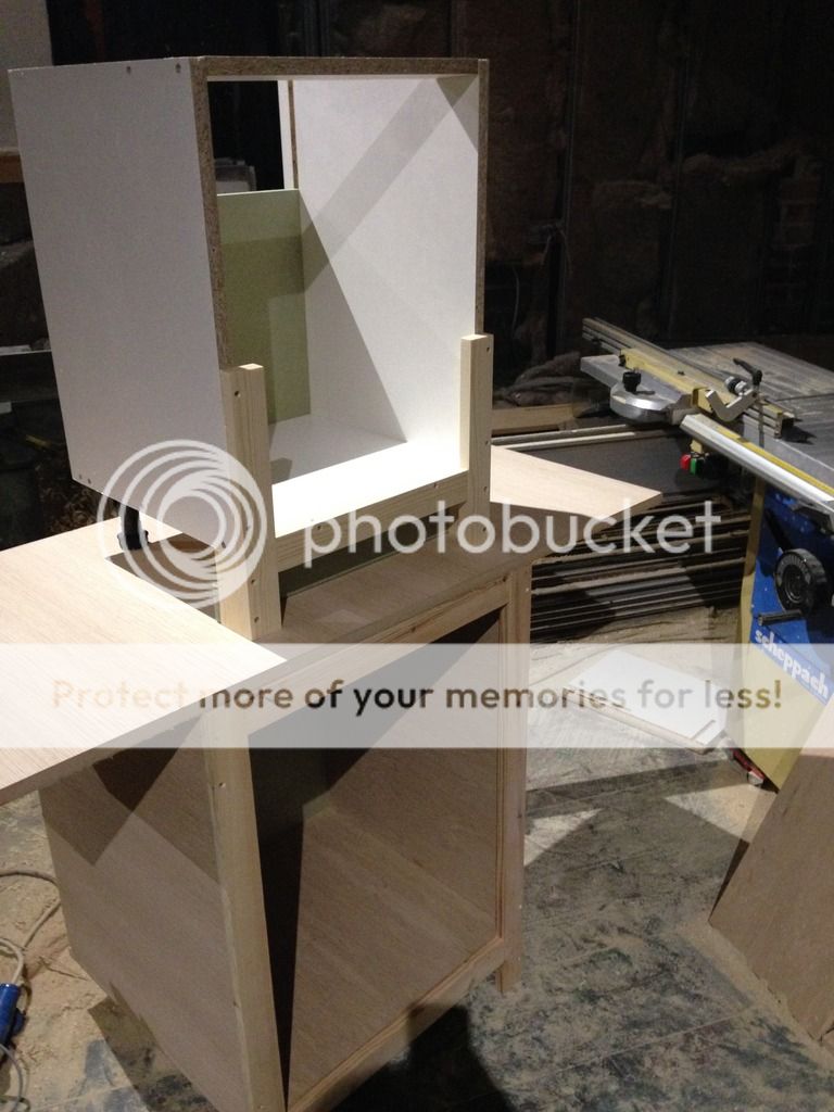

Hi Team,
I have not bothered anyone with stupid questions in a while, so here goes. I am making my kitchen in Jan / Feb as I have some time off work. I want to make a face frame kitchen (basically like every other nice kitchen there is). I have been looking forward and thinking about this for nearly a year. Inspiration is basically any one of the many fantastic kitchens people have made on here, or something like this - http://www.firedearth.com/kitchens/shop ... eestanding
Im hoping that some of you will impart some of your knowledge upon me as I have not made a kitchen before and have already learnt the hard way a few things from making my mock ups... These questions I think are probably very very simple (simple if you know how that is...)
Firstly I originally turned my nose up at using MFC, and bought veneered MDF. I was very wrong and the MDF was awful (like cardboard, no fixing strength) and the MFC was actually far better than I expected. I also had no problems cutting it on my table saw (I bought a new superfine blade which I didn't even need). So Carcasses will be Oak or Ash coloured MFC, shelves lipped with beech.
I have made a mock up of the base unit and have done it with housing joints, wood screws , little legs on the front and adjustable legs on the back. There is also a plinth set back, This is because;
1) Its going on an uneven (floorboards) floor and I want height to be adjustable.
2) I don't like the idea of a plinth and want the look of freestanding units, but don't want food and crap going under the units either. You can see what I've done in the picture - stuck bit of mdf on the back.
Questions is, will this be strong enough , as essentially the unit weight will be relying on the fixings between the face frame and the carcass, I was planning to pocket screw face frame and biscuit it on (No festool domino here I'm afraid) . Is there a normal way this type of unit is usually done ?
Also do you need dedicated MFC screws ?
And when you fit the kitchen, will not being able to get underneath the unit cause problems ?

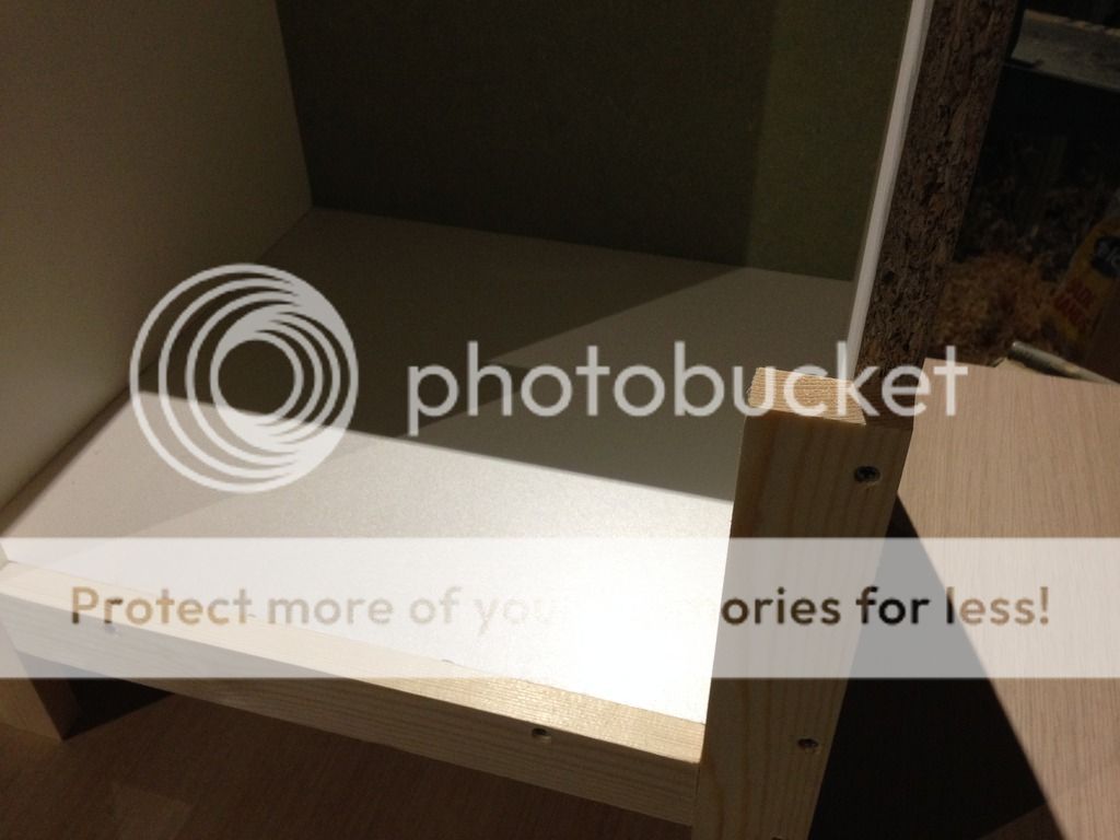

Secondly, in my mock up there is a gap on the inside of the door. Here my face frame is 50mm which is larger than the Fired Earth units (which is 25mm) , but in any event both units have face frames bigger than the carcass.
Question - What does one do with draws or if you have normal kitchen hinges ? Do you have to batton them out to be flush with the inside of the face frame ? I also wanted exposed dovetail sides of doors - you know the sort of thing.... what draw runners are usually used for this type of thing ?
Thanks for reading if you got this far and hopefully someone can help me as this is probably basic stuff that everyone knows except me !

I'll give you my opinion as no one else has replied yet, but is by no means the only way.
1. I'm sure your way would be plenty strong enough, but I think it makes it hard work to get everything level, and having the plinth screwed from behind will make adjusting the back legs a nightmare. I would use adjustable legs front and back (with the front ones set back to where the kickboard wants to go). Then you can level the carcasses, and scribe your faceframe legs to the floor. This way you can use standard clips for the kickborads and retain access.
2. Drawer runners and Euro style hinges would need to be packed out to the faceframe. Personally I think this looks naff on hinges, so I use butts on this style of kitchen, but up to you.
3. The drawer runners you describe are known as undermount (or concealed). If you want soft close then Blum and Grass offer nice units, Hafele do some of their own as a budget option.
Hope that helps.
Ben.

Post by rhrwilliams » Tue Dec 22, 2015 7:38 am
Thanks for the reply and your input .
I think battening the hinges is a little naff too - I'm going to have another crack at setting the face frame the other way so flush on inside .
I'll also try to do the plinth as you suggested and see how I get on -

Re: Kitchen
Post by karl » Tue Dec 22, 2015 8:13 am
I agree - make the face frame so that it only overhangs the inside of the carcass by 0.5-1mm. Also, you're giving yourself a shitload of work to do by screwing through the face of it - use pocket hole screws through the side of the carcass and screw into the back of the frame - no making good afterwards!

Post by rhrwilliams » Tue Dec 22, 2015 10:49 am
Thanks Karl - yes I was always going to use pocket screws - I just don't have a jig yet so just roughly screwed frame on

Post by thekarter » Tue Dec 22, 2015 4:38 pm
Line the frames up with the inside of the carcass then fitting draw runners is easy. Use good quality butt hinges.

Update - Ive made all the carcasses and milled face frame stuff. I made each frame individually , I could have saved lots of time milling it all up at once but I was frightened of making a mistake and ruining all my wood ! There must also have been a much easier way of cutting the c*ck bead angle than with a chisel. It took me ages.
Ive put the frames on carcasses to make sure the glue sets square and where I want it. Ive alto test fitted it because I couldn't resist and all is going well !
Im going to spray carcasses with another coat of morels lacquer, then project is on hold for a week or so as I have to go back to work on Monday and earn some cash.

For aesthetics I would have done the face frame in one piece. i.e. 36mm uprights between the lower level units.
Once painted a line will be seen. I'm sure it will still look great though.

Thanks , someone did point out earlier that I should make the uprights smaller too . To be honest though I thought it was a long run to Make in one peice of face frame and felt it would be much easier and more manageable for me in individual units , and give me less chance of cocking it up !
