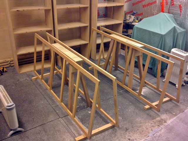

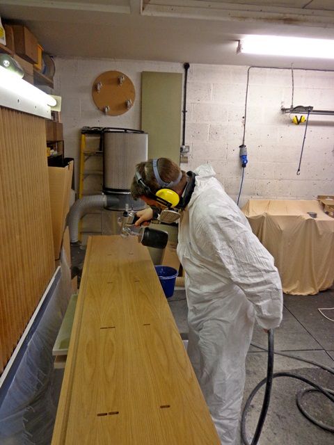

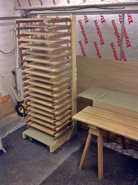

This weekend and this evening has been spraying time;
As usual I'm spraying it all flat prior to assembly. I'm using Morrells WB lacquer, 20% sheen. I've actually done the first coat in some 10% I had left over, with 20% going on as the top coat - the 10 is just a bit too flat for me. Interestingly the 10% is just over 2 years old, absolutely nothing wrong with it - I was worried it might have gone off but its fine. It sprays nicely, no thinning or pissing about, and dries pretty quick too. I've been finding that with some heat on in the room its dry enough to do the second side within the hour.
Everything has had one coat and been denibbed, just need a second coat on it all, which will happen one evening this week.
That's it for now.

I'm pleased to see you are taking your personal safety equipment seriously Ed.

Well I came into possession of a box of disposable suits, so I may as well use them. The ear defenders are essential - I don't know about other HVLP's but the Apollo is deafening.

Re: Utility Room Shelves
Postby modernist » Mon Feb 04, 2013 9:14 pm
If you stood on that castor board hanging on the wall you could wizz to and fro with ease.

Out of interest, which turbine sprayer did you go for? This one?
Postby Mr Ed » Tue Feb 05, 2013 7:01 am
karl wrote:Looking great Ed. Should be a posh utility room!
Yes that's the one. Great to use, sprays well, but fookin noisy :lol:
Postby karl » Tue Feb 05, 2013 4:29 pm
Cheers Ed.
The turbine route is an alternative I had been thinking about as opposed to the traditional compressor gun.

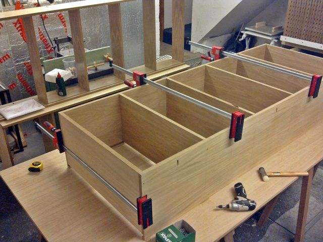

Having sprayed everything flat, I moved onto assembly on Saturday
I'm using the Spax carcase screws, which are excellent - no pilot hole and not the slightest sign of any splitting or bulging.
These cases are pretty heavy once assembled, each one having a sheet and a half of 19mm in it

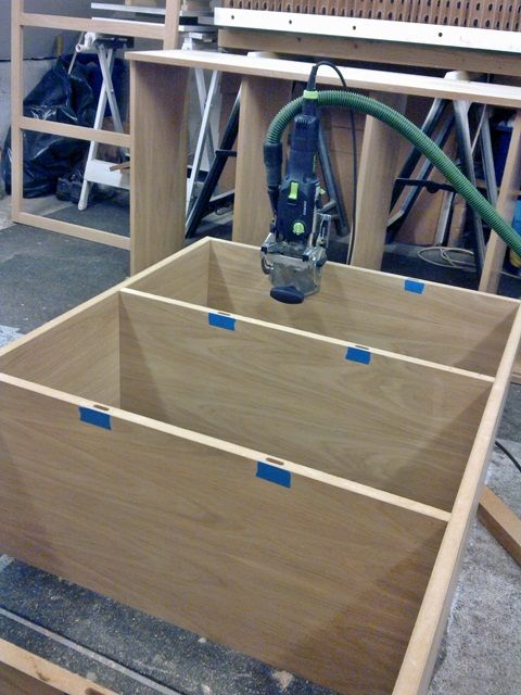

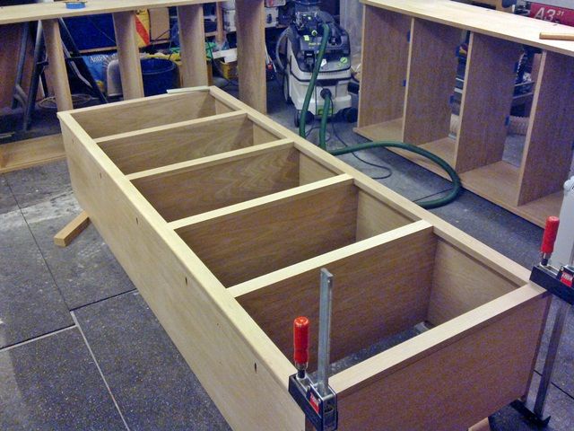

Once the cases were all glued and screwed, I moved into the face frames. These had been all dominoed on the middle size slot, so I could then glue and clamp them over the finished cases allowing me a little bit of adjustment to tweak the face frame so the alignment with the shelf edge was spot on.

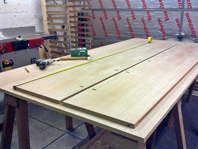

Once the face frames had been glued up I cut the domino slots on the edges of the shelves and the rear of the frame for when I fit them later.
