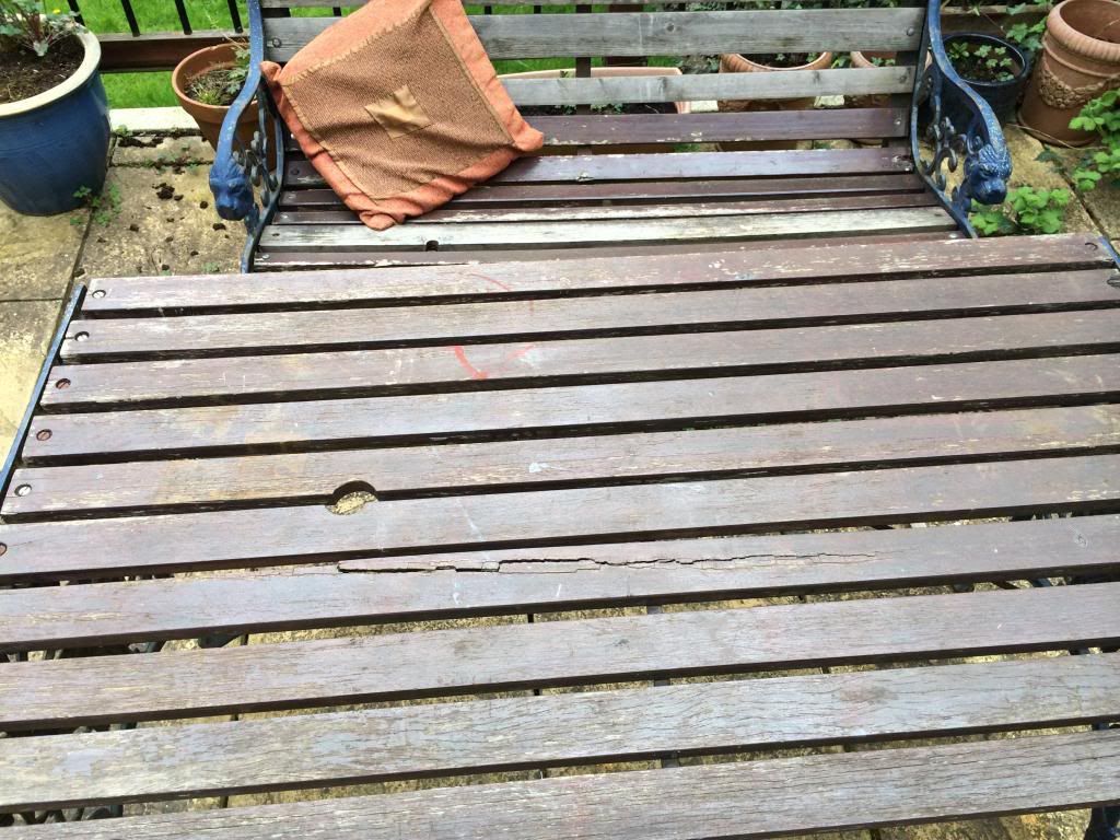

I bought a set of garden furniture at my local salvage yard, it's in a very sorry state:
I'm having the metal shot blasted and powder coated and have just taken delivery of some Iroko I have had machined down by the timber merchant.

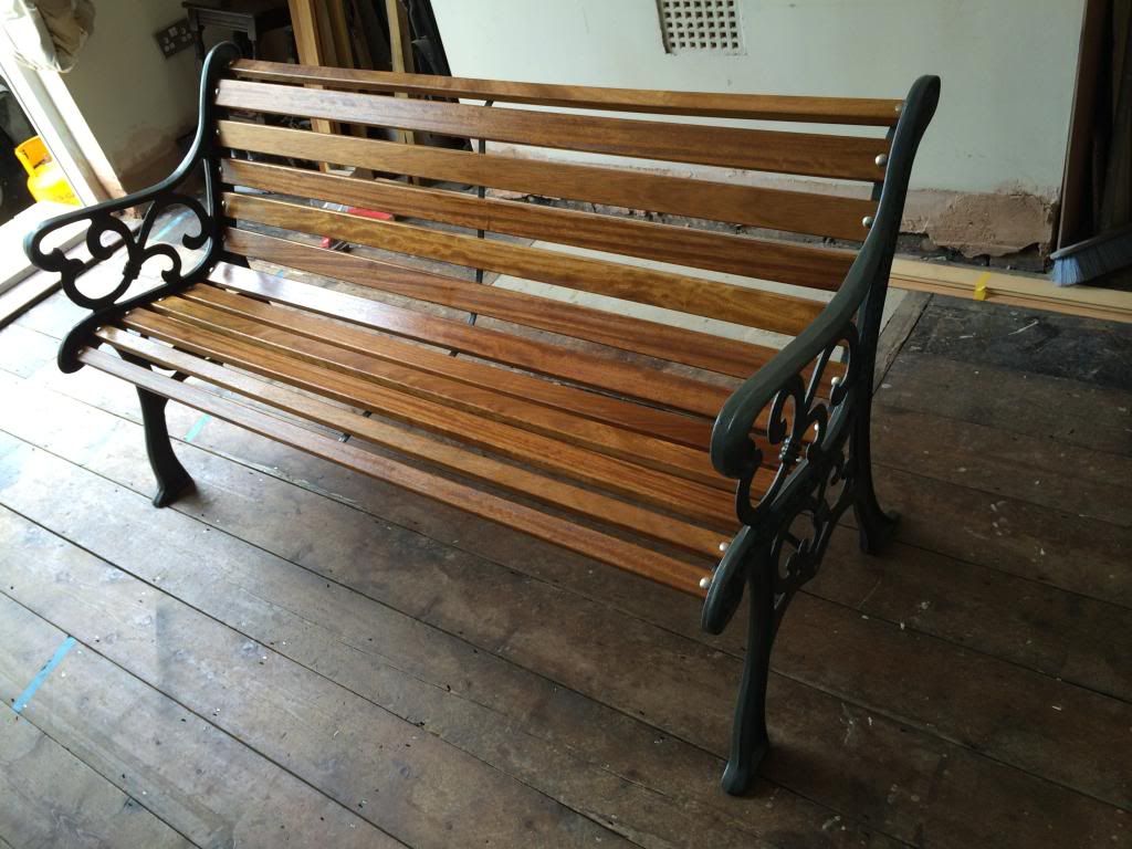

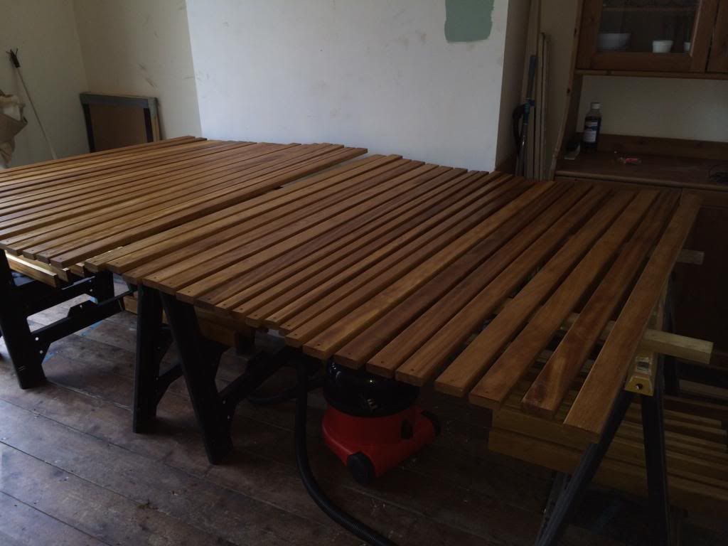

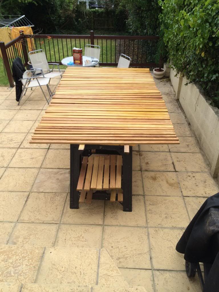

So I've finally managed to assemble all of the garden furniture.
I used Barrenttine clear wood preserver fist:
Typically the weather turned, so i brought the Iroko indoors and applied the Osmo Oil 420:

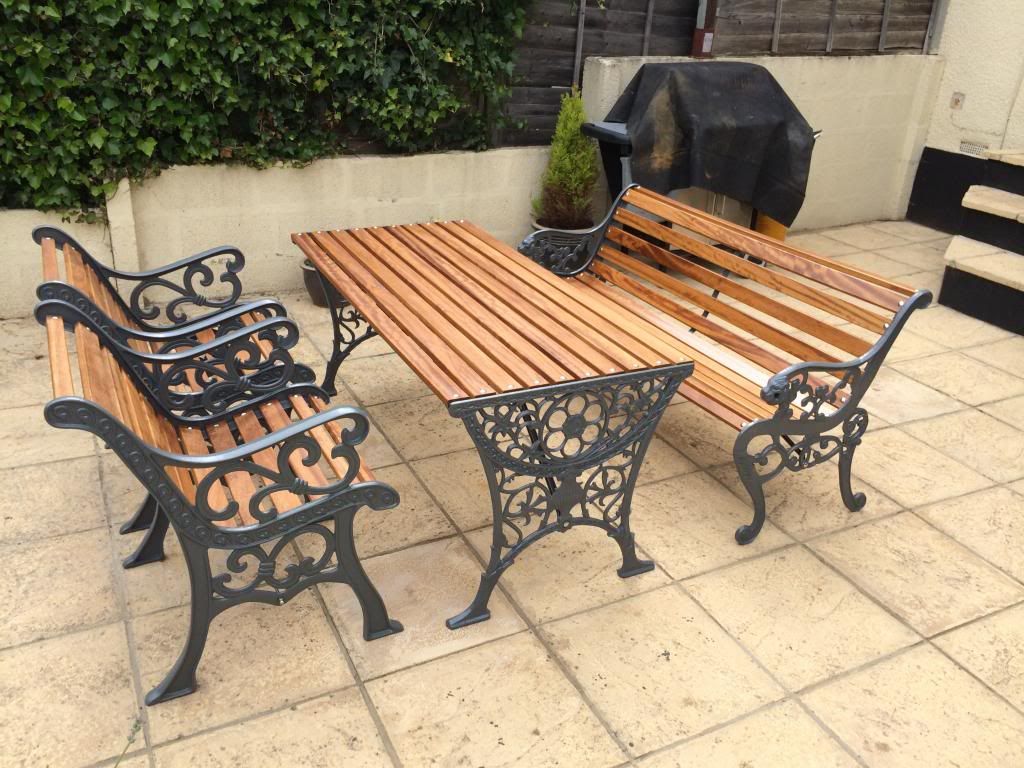

Here's the finished article:

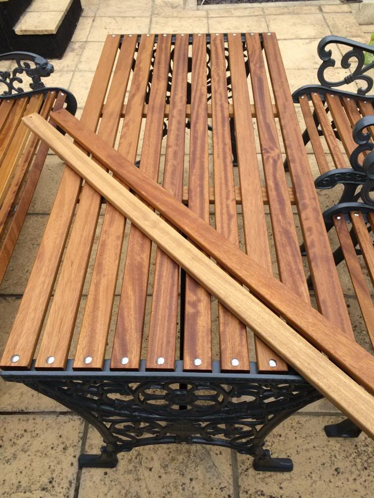

Here's a comparative shot of the Iroko which has just had clear preservative (left) and the other slats which have had a few coats of Osmo 420 UV Oil:
As you can see, it looks a warmer more golden colour with the Oil.
I'll report back to show how it holds up!
Re: External iroko - Osmo UV Oil or Sikkens Cetol Filter 7
That looks very smart, I have a similar job to do myself if I can find the time.

Re: External iroko - Osmo UV Oil or Sikkens Cetol Filter 7 Plus
Hi all,
I thought I'd report back after my experience of the Osmo UV oil.
I'll have to get some pictures up, but in short - i've been extremely disappointed.
The Iroko table show signs of silvering after a matter of months, even with a few coats of the Osmo UV oil. I guess it's to be expected as it takes a UV battering pretty much all day until 5-6pm when the sun moves over the house.
My next test will be to use the Osmo UV oil again, but the tinted Cedar version: http://www.osmouk.com/sitechaptern.cfm? ... 2&page=262
I'm not holding out too much hope, but if this doesn't work I'll bite the bullet and use a woodstain such as the Sadolin Ultra which features in the video which Roger posted above.
