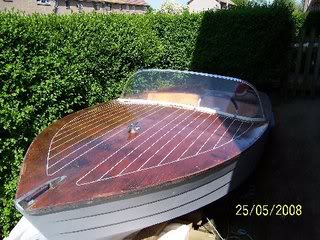

sikaflex 290 looks like what I am after but your comments have worried me. Why wouldn't you have it in your house? Is it an appearance thing or does it not finish very well? I plan to finish with this on top which I have used and is an excellent product.
