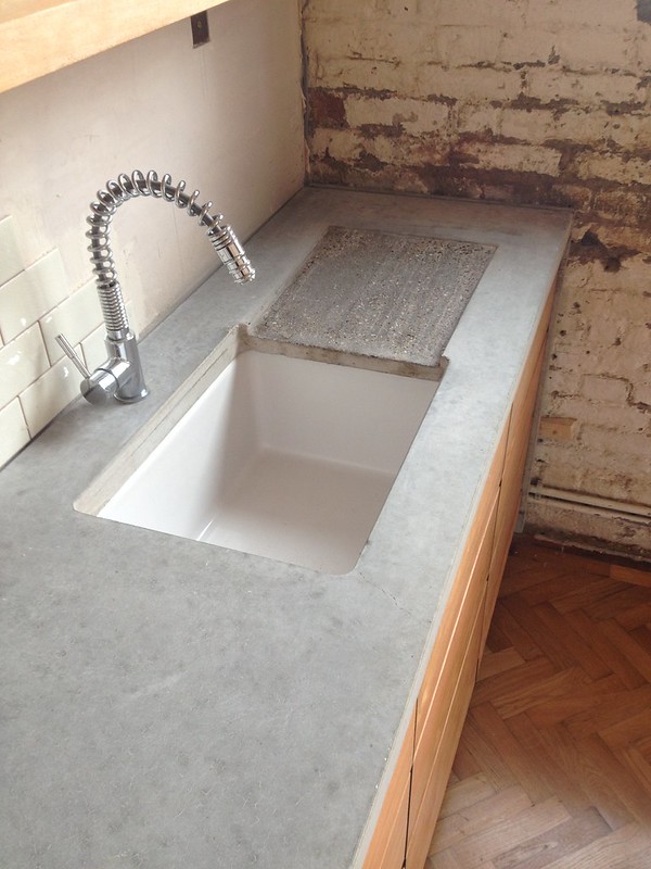

Well... after hours spend on my knees (ahem) she left the shop and is proudly sat atop the island...
All the pics look kinda the same, but since everyone was so helpful, thought the least I could do was post a couple of pics!
Former made from Melamine faced chipboard, on some 6x2"s that I had flattened and screwed into a rigid torsion-box type o' thing...
I had made a grid of rio-rods (12mm diameter) tied on approximately 200mm centres. Dumped about an inch of muck in the former, tamped it like crazy, then floated the reinforcing on this, with some wire tied to the sides to stop it sinking when I gave it a good old shake! Dumped the rest on top to give me circa 50mm of 'depth'. The mix was as advised... three bags of pea shingle, three bags of sharp sand, a bag of dust, and as little water as possible.
I thought my vibrating device was inspired... an sds drill set to chisel mode with a very blunt chisel in it held against the former.
After about 10 days, popped the sides off the former. Couldn't bring myself to flip it over... so left it another 5 days...
Was really pleased to turn it without it folding in half, but initially concerned about the 'ghosting' of the rio rods... Left it another 5 days!!!
Spoke to an incredibly helpful chap at ATS diamond tools, who talked me through the polishing process, selling me the bare essentials to get it done without going bananas and buying all the gear.
I managed to use my electric polisher (grinder is too fast) with their copper-bonded discs (4") with just a brush to sluice water over the surface.
Boom!
As always... handles to follow!!!
Thanks again to all of you for your help.
Boom!

Nice job turned out well. Looks really crisp, is it ?

It is crisp, but not without air dimples and the odd pin-hole. Fortunately my clients wanted a more rustic look, so SUPER crisp wasn't a requirement, and I only needed to polish it to circa 200/400 grit for a honed finish.
If I was going for a flawless finish, I would use densifiers in the mix, and make sure I could get under the whole former to vibrate it...as I did it on the floor I was limited to only knocking the edges.
Pete
Pete

Very nice, thank's for posting.
Re: Concrete worktop
very good job, i love it

That looks really good.
