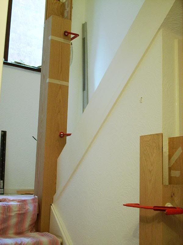

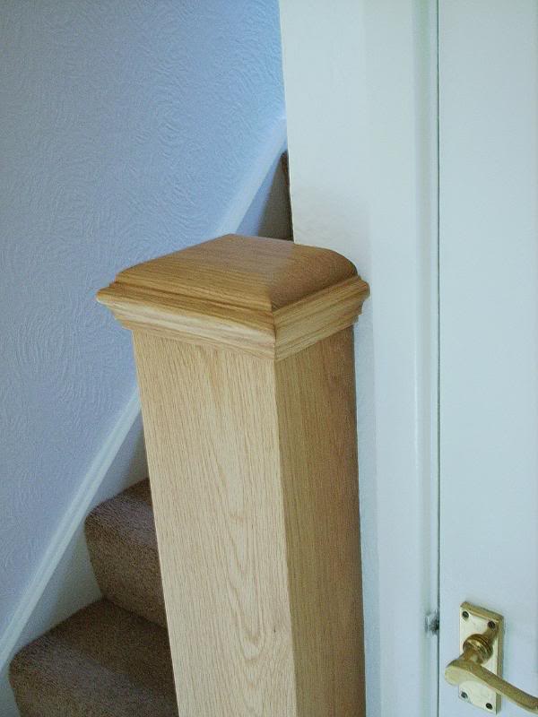

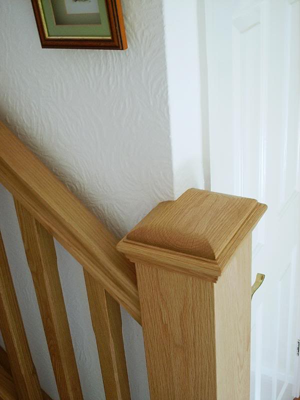

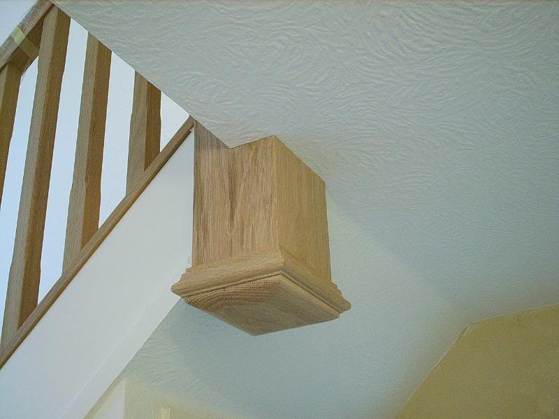

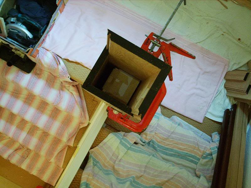

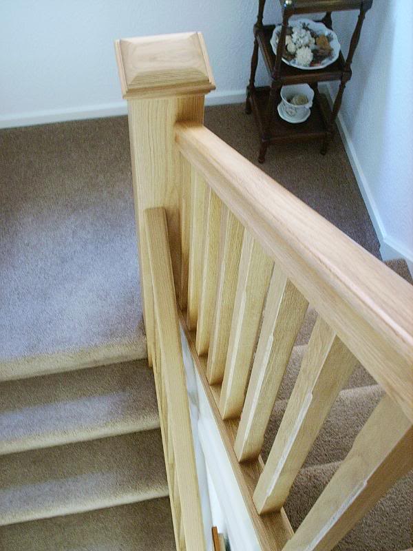

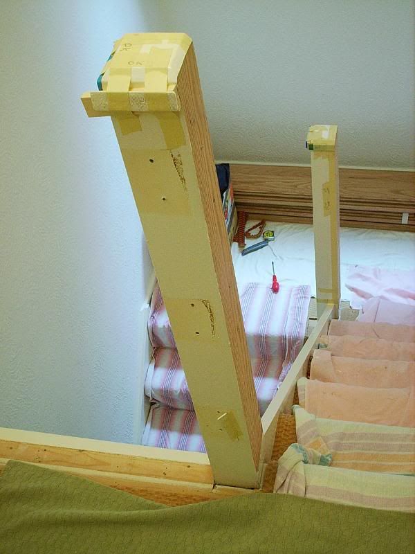

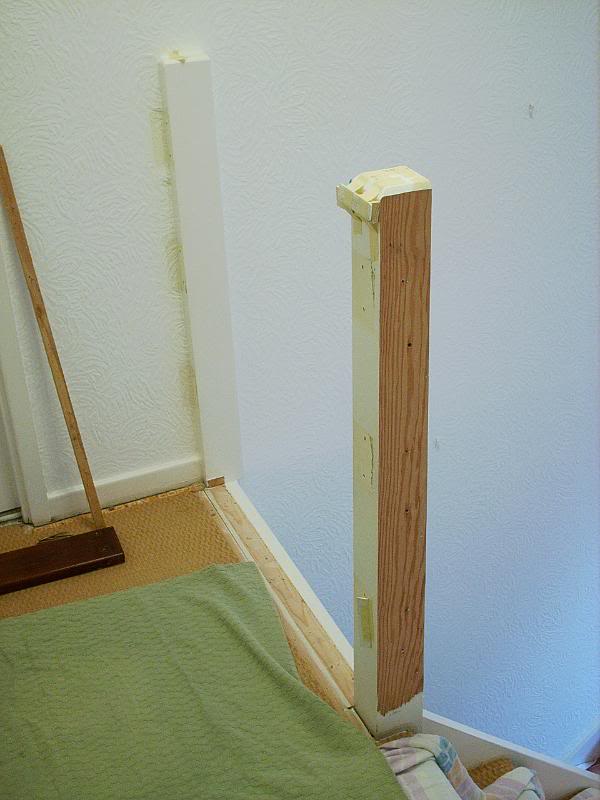

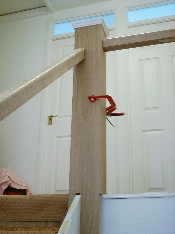

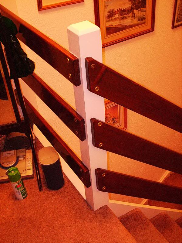

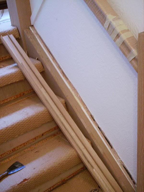

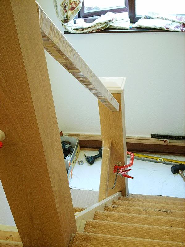

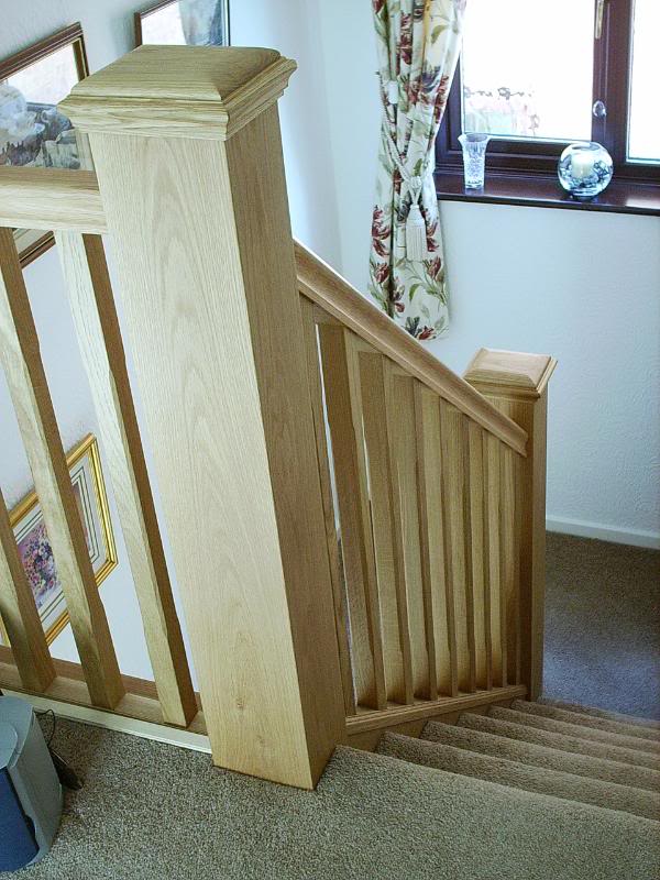

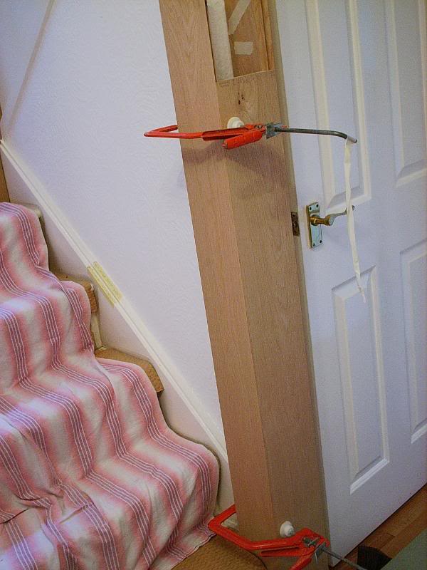

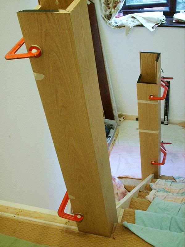

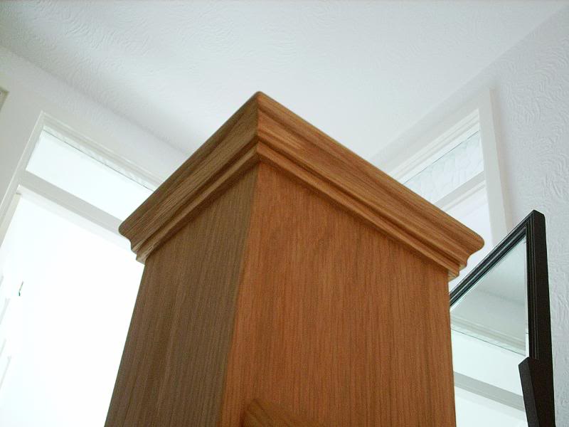

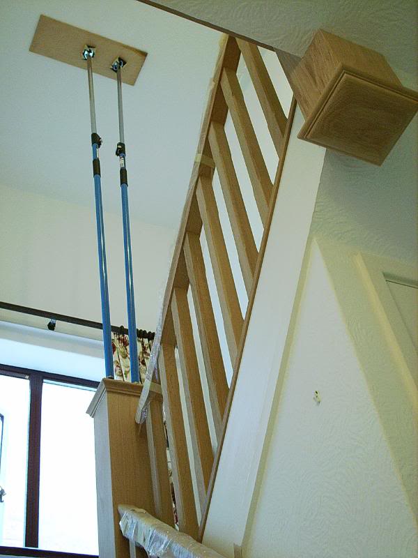

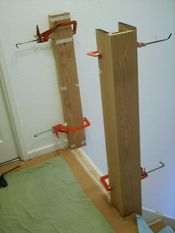

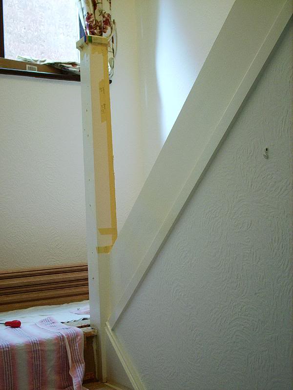

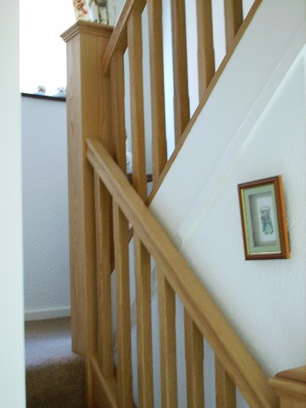

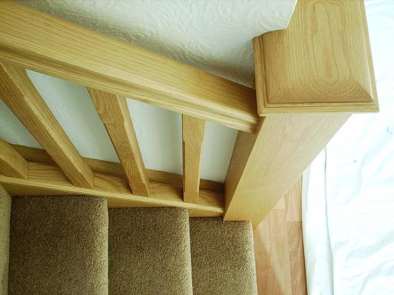

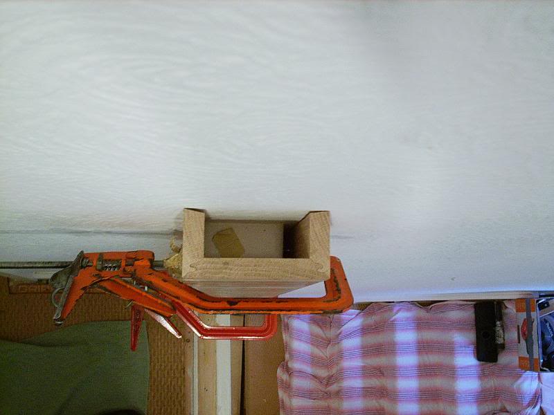

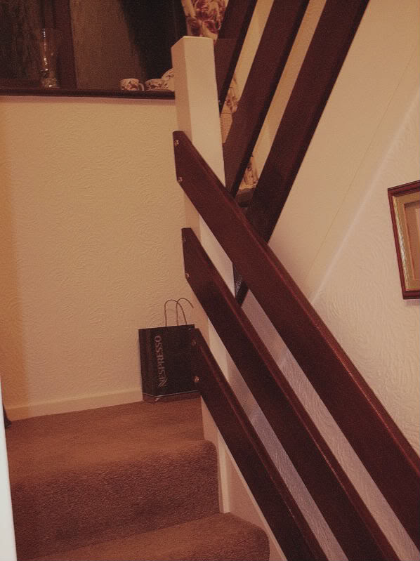

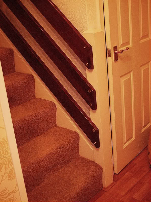

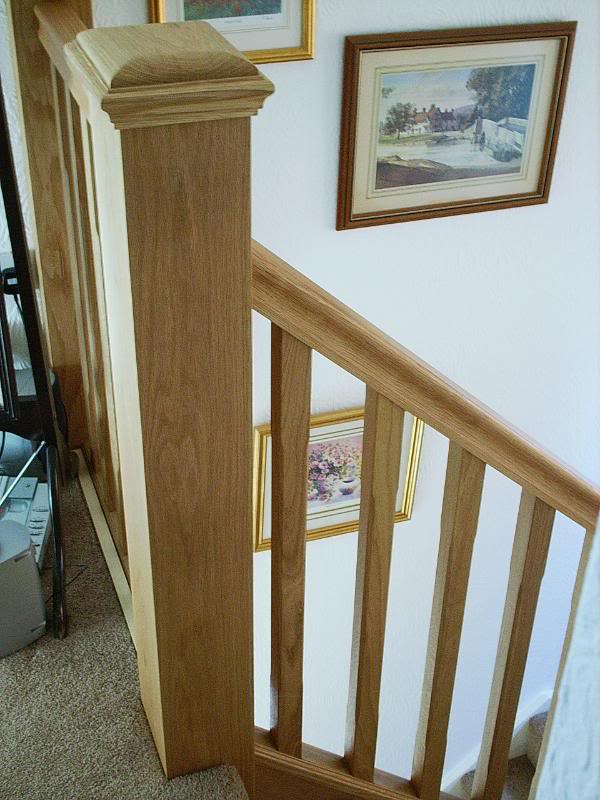

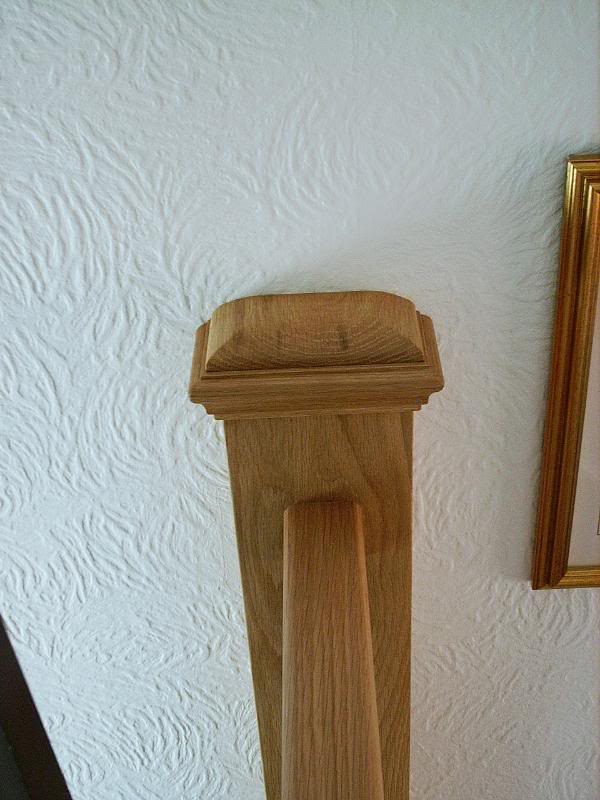

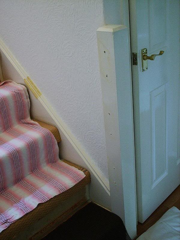

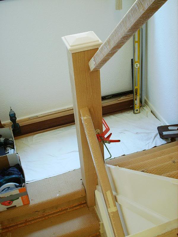

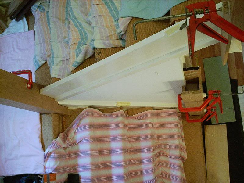

Dogleg stairs that needed changing to Oak.

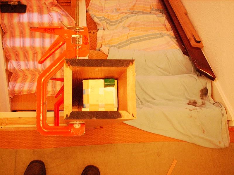

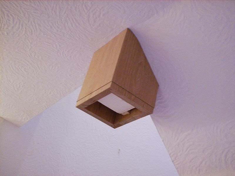

Newels were built up using the Whitehill Mitre-lock spindle block which allowed them to be clamped up quite easily.

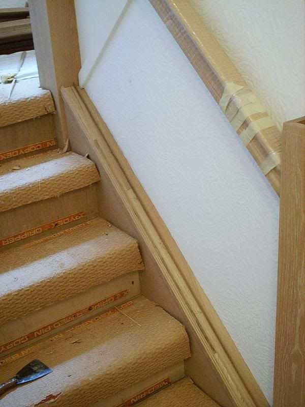

Strings were packed out to make things work with MDF which they were going to paint but changed their mind and it worked really well with the Oak.
Here are the pictures which more or less tell the story of this job ;)

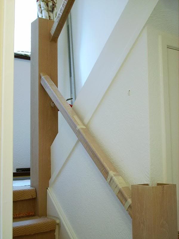

Andy
FINISHED

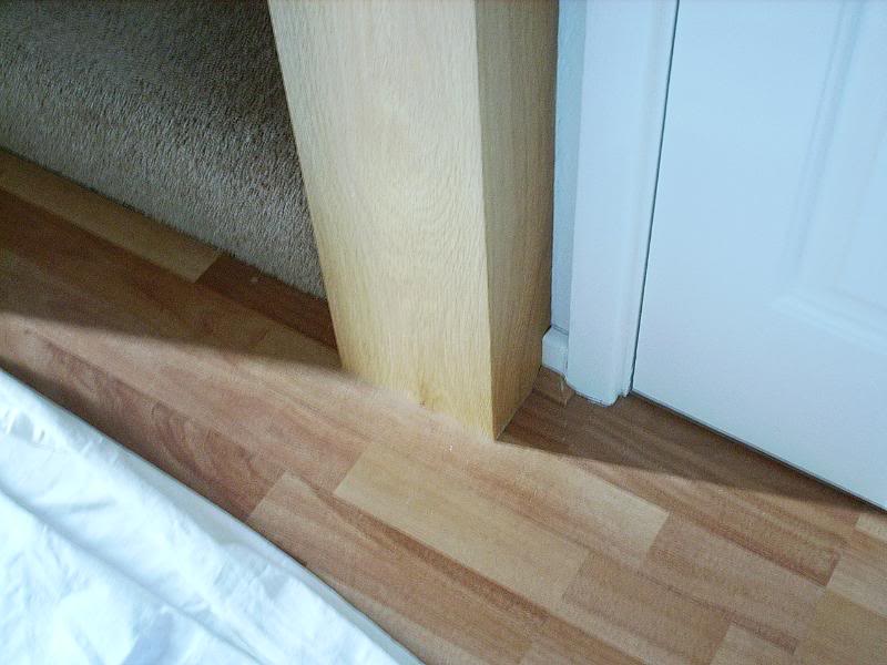

Re used carpet on landing that left a gap :oops: :roll: Now sorted with oak infill ;)

Postby sainty » Thu Apr 05, 2012 10:04 pm
Very nice.
Looks labour intensive, but the results are excellent.

A great improvement. Ive been using the whitehill ML block for the first time recently and its very good.

Top job - a silk purse from a sows ear.

Nice result and a tremendous improvement (even though I like 60's stairs :D )
How did you get on with the corners of the MDF and the mitre lock? I did a job with wenge mdf and it was difficult to make a smooth edge without risking going through the veneer or creating splinters.

Excellent job - I fitted something similair (but was made by somebody else), but don't have pics.
Brian - it looks like solid to me, rather than veneered MDF.

looks superb, I like it a lot I am huge fan of chunky

Lovely job, very pleasing to the eye.

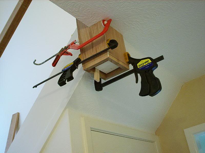

Could you tell me were you got your plasterboard props & what there starting height is? I bought a couple from toolstation recently which fell apart on first use :evil:

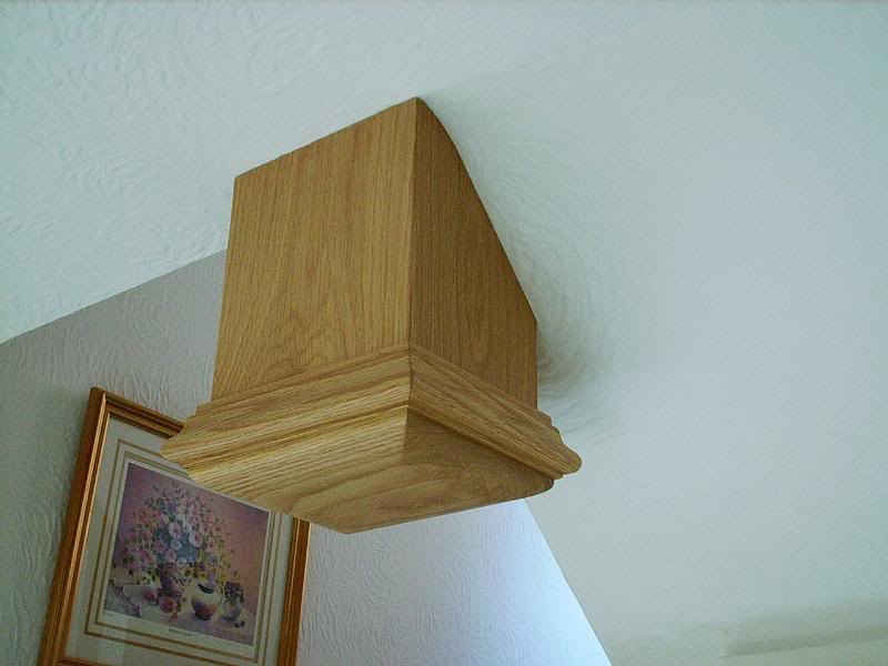

Nicely done. The newel caps really make it.

Yes it was a mare of a job to get right as it was mostly done off the cuff ;)
Would be nice to have a couple more to do, now all the sorting out is under my belt and give me a chance to make a bit of dosh :roll:
Glad you like the newel caps....

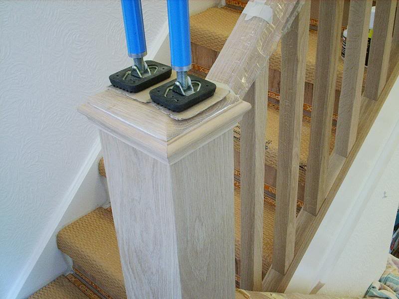

Simon
The props start at 1600 and extend up to 3000. These were either from Aldi or Lidl and really do work well (100% no slip back)
Andy

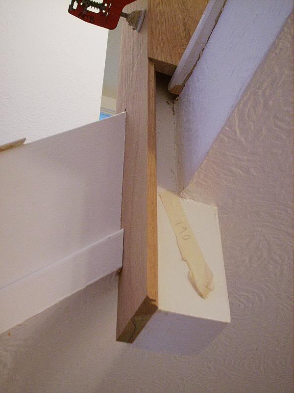

I would like to do a similar job to my newel posts.
How did you make the cut out where the newel post cladding fits over the stringer?
How did you attach the cladding to the newel post as Samson asked above.
